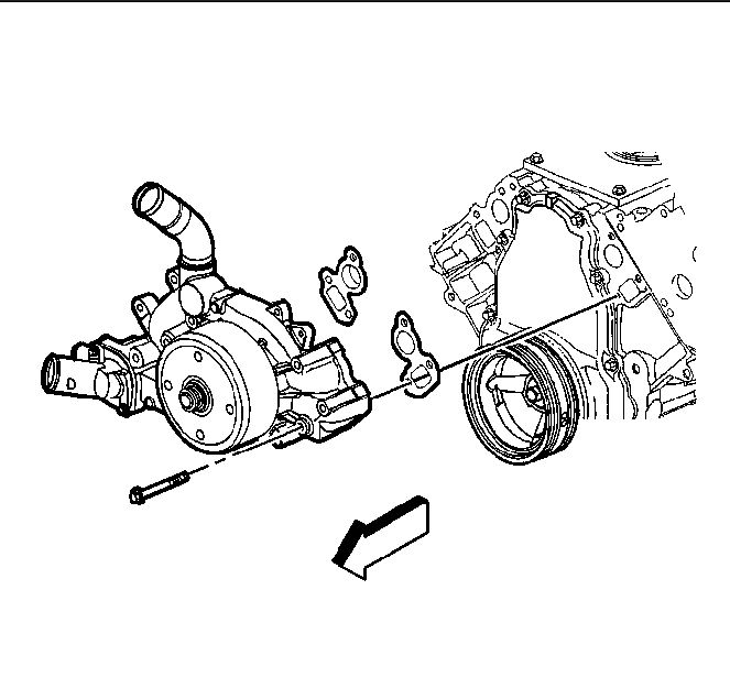

Judging from the picture, it dosent look like it has any of the short stubby rubber hoses like some water pumps do... It could have been a gasket blow out, but I would think that you would have been leaking coolant before the blow out...
Were you adding fluid to it prior to?
Attached Thumbnails 04 Sub - Major Coolant BURST !! Help.....-2004-waterpump.jpg
