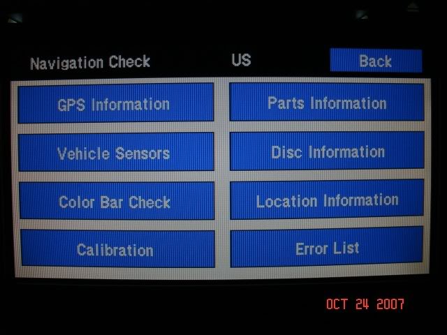

Did the dealer actually try the calibration screen?
In NAV map mode, press and release NAV RPT, then press and hold CONFIG until the NAVIGATION CHECK menu pops up (about 12-15 seconds).
Hit the calibration button and follow the directions.
