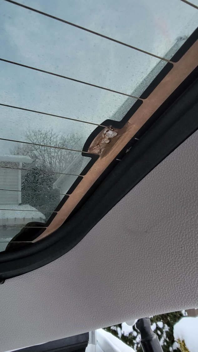

Rear window right side connection. I barely touched it and fell off. How do I fix this

Been there, done that.
Permatex makes a tab repair kit. I did that on my Tahoe but it did not hold up. I wound up heating up the metal tab so a blob of molten solider stayed on the tab and stuck it onto the window. I then used the Permatex kit's orange copper paste paint to paint around the metal tab to make the connection even better.
It's over a year now and so far so good. I'm in a colder area so every time I remote start the rear defroster goes on automatically so it gets used a lot more weather I like it or not.
Other than that it's change the glass.

I cleaned both sides with a wire wheel. Added solder to connector. Held with pliers against window and solder back on. . It works now
