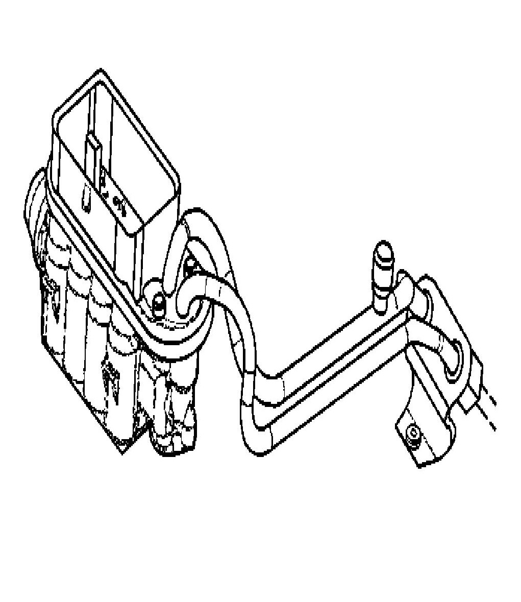

where do I check the pressure at....
Old Sep 23, 2010 | 9:17 PM
Likes: 48
should be right on the fuel pipes going to fuel meter body...
unscrew the protective cap and install the pressure gauge....

What should the fuel pressure be at before start, and after shutdown? Should there be any bleed down, and how much?

Is there a special tool for testing the fuel pressure using that spot you told me about (under the protective cap) or just any "pressure tester" also I am looking thru my chilton right now and I cannot find where it says what the fuel pressure is supposed to be. Can I test the pressure during the 3 second prime mode with the key in the "ON" position or does the truck need to be turning over when I test? By the way, thank you for your time!

I'd guess at least 45 psi, not sure about leakdown.
chev1989: The fuel port will look like a Schrader fitting similar to an A/C port.

I found the fuel port I just dont know what to test it with or what status the fuel pump needs to be in during the test...
Old Sep 23, 2010 | 10:14 PM
Posts: 11,340
You need a FI fuel pressure gauge. You can check with the key on, engine not running.
