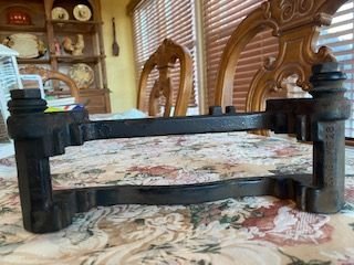

A picture is probably worth a 1,000 words. So, that left boot is the one giving me troubles. It looks like only one of those billows is flexible...the other one looks crushed. So the left pin doesn't have the same amount of in-and-out travel as that right pin. I'm guessing it's time to replace these, but let me know if I'm missing something. Thanks again.

Thanks repairman54. I think I might be over-analyzing this, but let me check. If I pull out both guide pins and break the vacuum, and then reinsert, both pins are about level.
Then, as I start pushing them both, one boot begins to collapse a little and won't push the pin back as far as the other.
I noticed that my interior pad had a lot less material (basically none) than the exterior pad. That's one reason I'm probably over-thinking this. However, these bushings look like a real pain to install, so I'm not trying to create a tougher job for myself if replacing these is unnecessary.
Here's a better shot of each to show the difference. I'm not having any problems from this one:
The other one starts out looking like this:
And then after about 10 pushes...it flattens out a little to look like this. Af this point, their is 7mm difference from where this pin sits vs the other side.

As long as you can move them by hand and they are not rusted up they are fine. It's just that one is sealing air better around the boot than the other.

Thanks repairman54! That's exactly the reassurance I was looking for. I'm heading back to the "shop" (aka my driveway) now. Much appreciated : )
