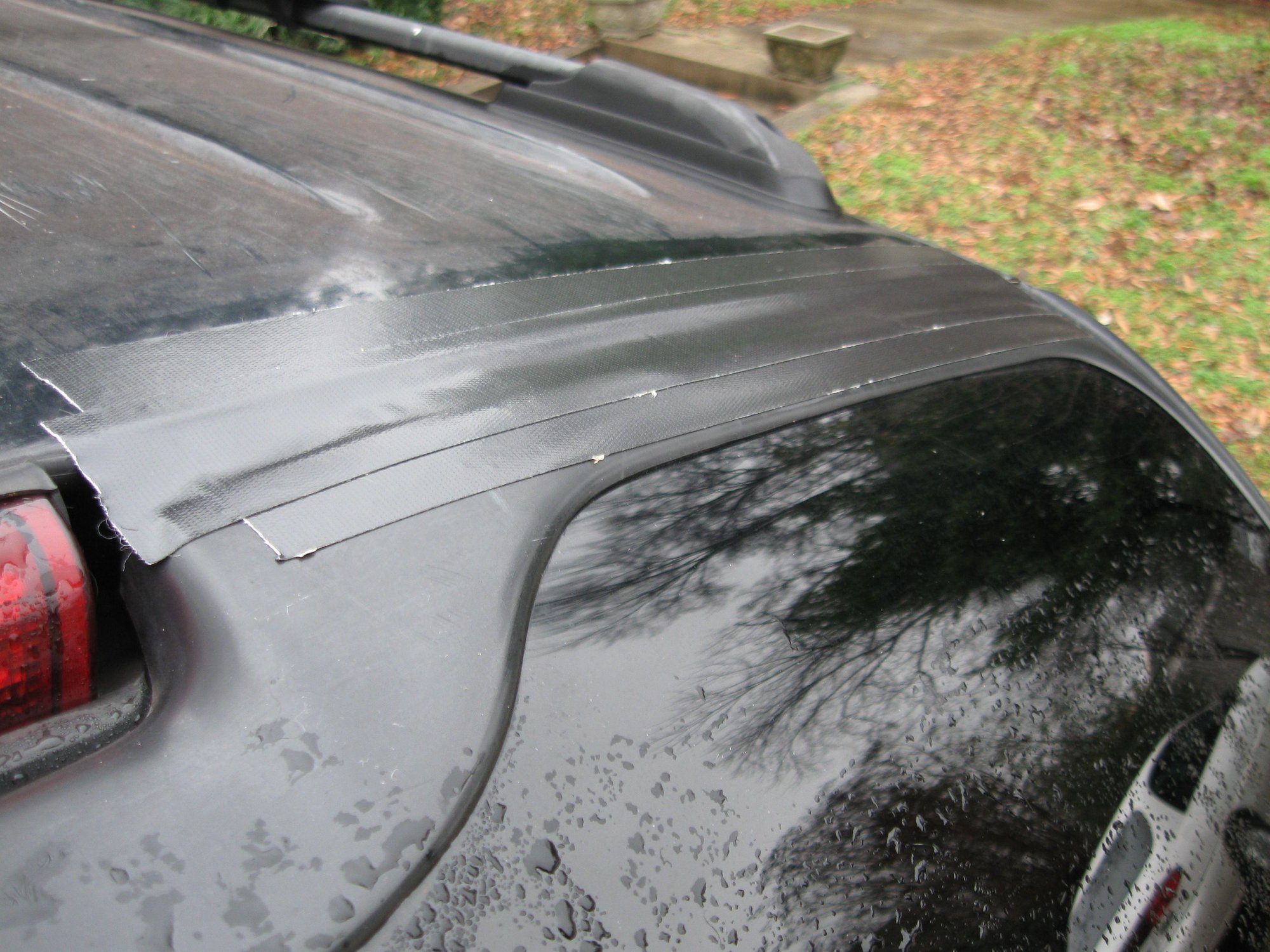

2003 Chevy Suburban. black: Just bought it, 135,000 miles, rebuilt transmission, ordered struts for lift window as they were missing - tried to install struts and right side hinge came off. Then, I read this thread. I repositioned the lift window and Gorilla taped both sides. Not noticable from the ground. Similarly Gorilla taped tailgate to pickup bed two years ago, and it still functions as an air block; tailgate down & up, often.
Hinge broken - black Gorilla tape to the rescue.
