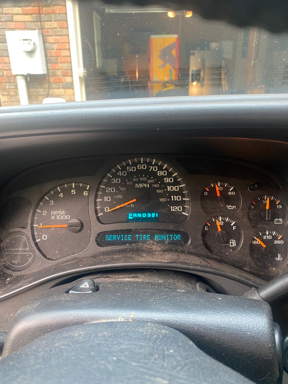

The Service Tire Monitor warning is displayed, but the TPMS dummy light never comes on. I ordered new valve stems, replaced all four and did the manual relearn for them. It all checked off. This stupid message still shows up. Any ideas?

there may be a code but a cheap code reader can't access it. tpm codes are set in C or chassis systems. Have someone with a full function scan tool check for dtc.

What about the spare tire? Did you pump that up or replace its sender???
