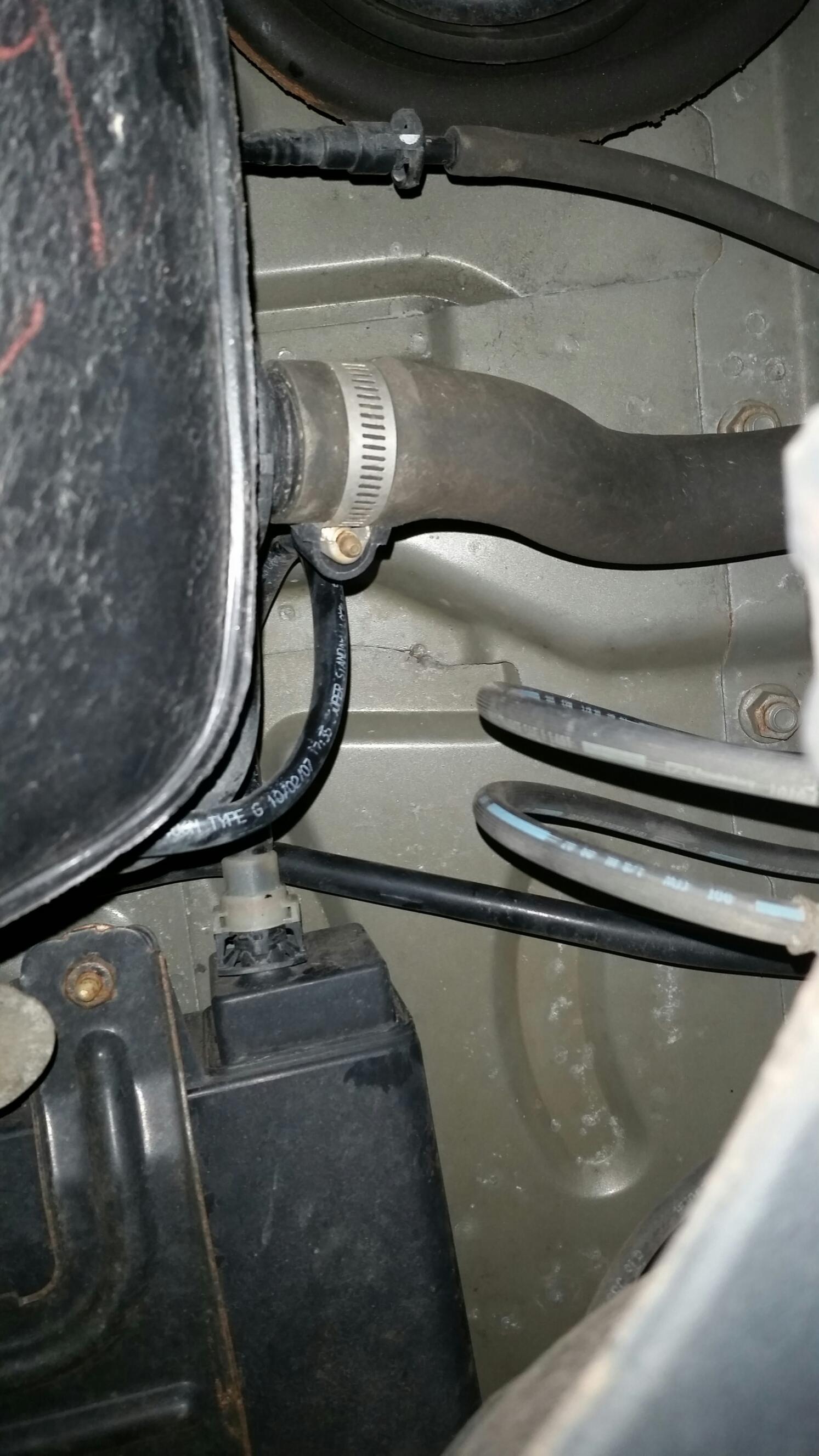

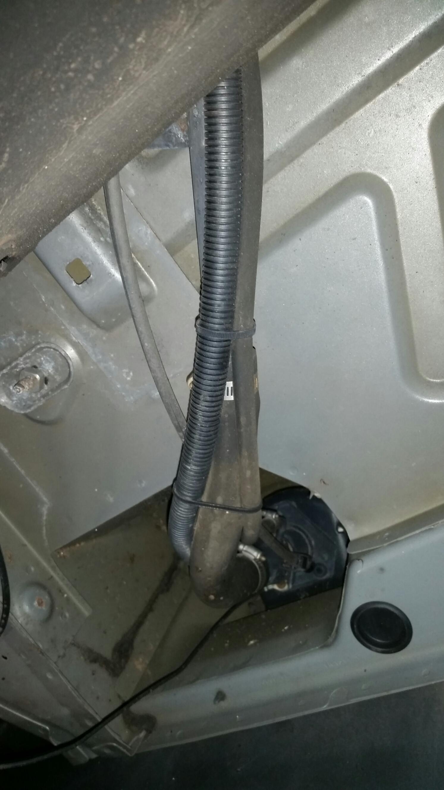

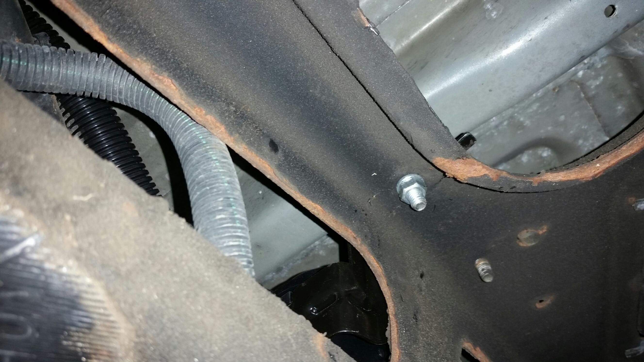

Can't thank you enough for the help and the part numbers! The correct part was the 20995472. The dealer wanted a crazy price but after asking for a better price sold it to me for $64. It is everything you need except the wiring harness #19257603. The harness was $21.
Now the new part is different and you'll need to use new bracket. It took me longer to take down the spare tire than to remove and reinstall the new part.
Amazon has the parts cheaper but I had time and the dealer had them in stock. Said he can't believe how many of these they are selling..hum..
I took some pictures and will upload later, maybe help someone out. The only tools are I needed were wire cutters to clip the old ties. There was already a hole on the frame where the new bracket needed to go. I used a bolt I had laying around.

Default Photos of the process
