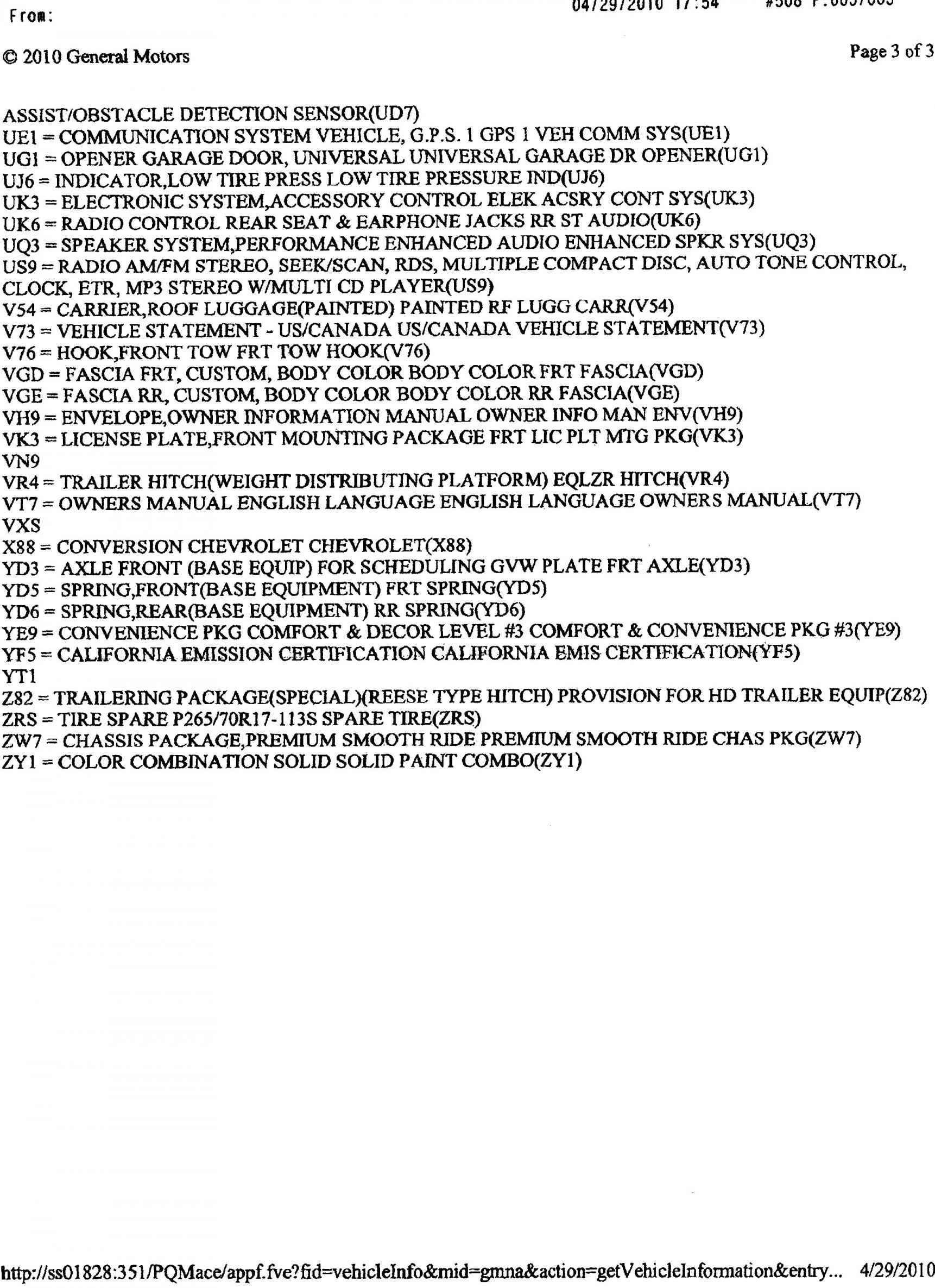

So, I got the RPO codes, with descriptions of each code (actually, my wife got them last year when we first started looking at trailers) and it appears our Suburban does not have either the tranny cooler or the engine oil cooler. I was searching on another site called etrailer.com and asked one of their "experts" about products, and he directed me to a kit that was had both coolers and the necessary adapters. Anyone have any opinions on specific products out there? I might be making more of this than I should be, but this being our first trailer, I really don't want destroy our urban tank pulling the darn thing : ) I've attached the code sheets for anyone who wants to look.
Attached Thumbnails 2008 suburban engine oil cooler and transmission cooler-suburbanvin1.jpg   2008 suburban engine oil cooler and transmission cooler-suburbanvin2.jpg   2008 suburban engine oil cooler and transmission cooler-suburbanvin3.jpg
