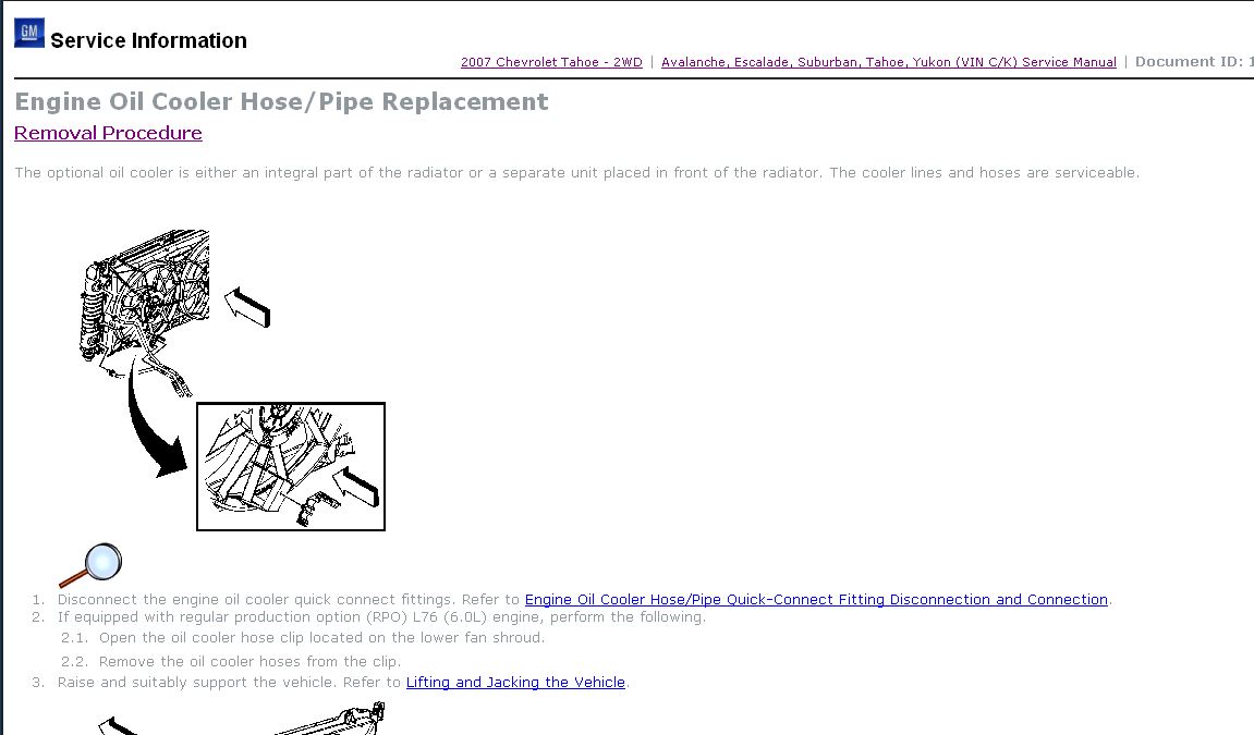

Old Dec 20, 2013 | 11:21 AM
  #27
Likes: 48
picture #2 looks like it could be the power steering pump hose leaking....
I don't have the engine oil cooler on my 07 but I did on my 97 so I am making some assumption that it would still be similar.
Okay took a look at the manual and that is correct...

Old Dec 20, 2013 | 12:21 PM
  #29
Likes: 48
Sorry, I meant that yes the engine oil cooling line IS on the drivers side of the radiator...per the attached picture in post #27
