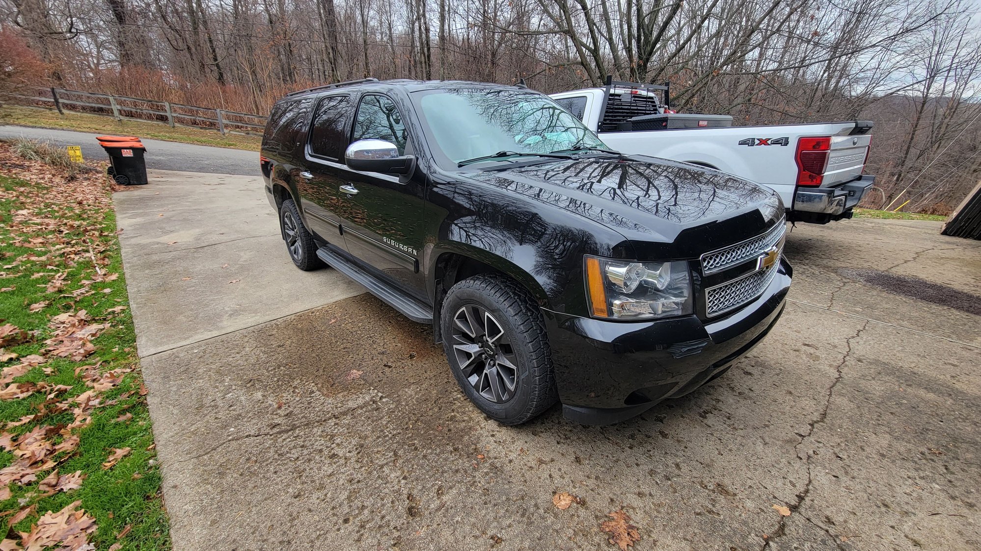

Decided with pur tires going flat we would upgrade our old 20s from our suburban to a new set of takeoffs. Took it to pepboys where weve gone before, installed tires, wheels and they added sensors. They left the old wheels and tires alpne of course. All was fine, but 5 minutes from the house my tpms light came on and none of them would read. Next day i went to take it back, they miraculously all worked, so i let it go. Fast forward a few more days and once again ot working. So, i took it in today, only for pepboys to tell me their scantool was locked out and the computer was programmed to the tpms. My question is am i missing something here? Not sure how they all 4 read just fine when they were installed and relearned. Just find it weird for all 4 to go and now all 4 will not accept a relearn. No previous issues before either. Any input is appreciated
