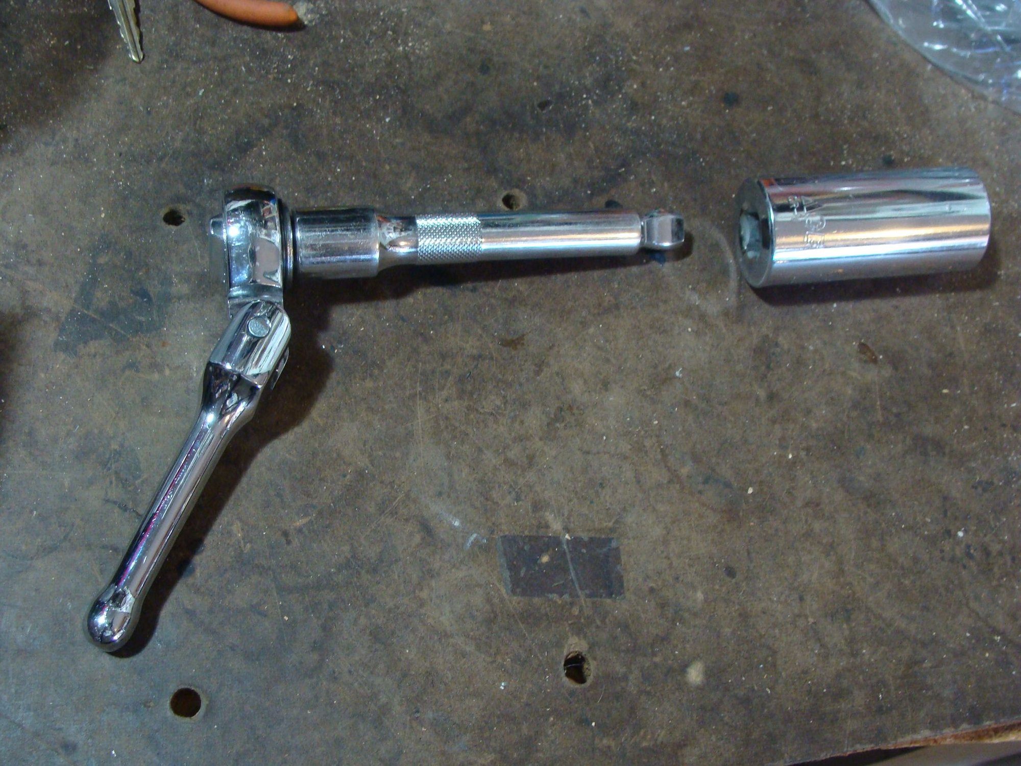

One should know that I watched quite a few YouTube videos before starting, but still had to lay towels over the engine, use a stool, and do some of the work left-handed. I was able to remove one end of a plastic tube at the rear of the engine for more clearance. I did not remove a second tube or the fuel line at its connection. I broke off the gray "protector" on the oil sender harness connector with a screwdriver, and with left hand pushing a long screwdriver against the connector tab and right hand on the connector, I was finally able to release the connector from the oil sender. The special 1 1/16" oil sender socket I bought like 25 years ago did not fit over the sender, I used a 27mm deep socket. Then I used a 1/2" wobble extension, about 5" long, and that was not easy to push into the 27mm deep socket, but the socket had to go on first. Then I used a stubby 1/2" drive flex ratchet to unscrew the oil sender.
Of course once that was unthreaded it fell somewhere so that took 15 minutes or more to find & remove. So I went to O'Reilly and bought PS508 oil sender, which actually did fit my special socket (but I still used the 27mm deep one).
So with the new sender (I did not even try to find if the engine had a filter screen, I didn't feel one) purchased, I tied a piece of twine around it it case I dropped that, and screwed that in a few turns with my left hand. Then I put the 27mm deep socket over that, then the wobble extension, then the stubby flex ratchet. 15 minutes later I had that screwed in, and actually in similar orientation as the factory one. So 10 minutes more to remove those tools without dropping them. So 15 minutes later I was able to blindly turn the connector to correct orientation to snap that on.
I re-connected the one plastic pipe I had removed, and started the Yukon: no oil pressure displayed, and check engine light was still on. So I disconnected the battery, touched cables together to erase all codes/clear computer, reconnected the battery, and started it up: all was working - SUCCESS !!!

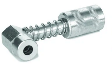

Today I raised the Yukon front and lubed the outer tie rod ends with my grease gun. Since the tires/wheels are so heavy, and my wheels interfered with getting my grease gun onto the nipple, instead of removing the wheels I purchased a right-angle adapter for $5.50 from O'Reilly, and it worked well.
