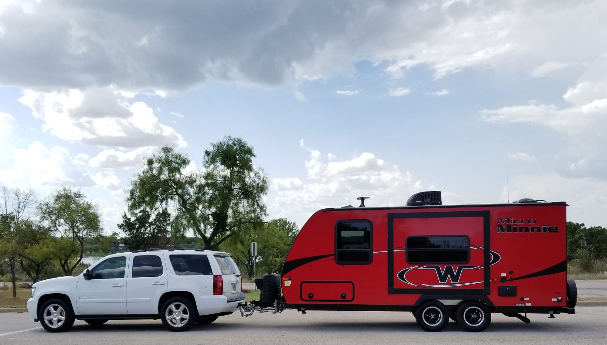

I tow a TT of about 4k lbs with my 2007 Tahoe with the 3.42 gears and the 5.3l. I have added the trans cooler. I haven't had any issues other then some sway due to the shorter wheel base of the Tahoe... Other then the trans cooler, the only other things I have added is the Tekonsha p3 brake controller, and the Husky WDH, the weight distributing hitch is a MUST. In hilly terrain I do stay in 3 , on flat road OD is fine, I have found the transmission stays cooler in 3. We have yet to do any mountainous areas.
