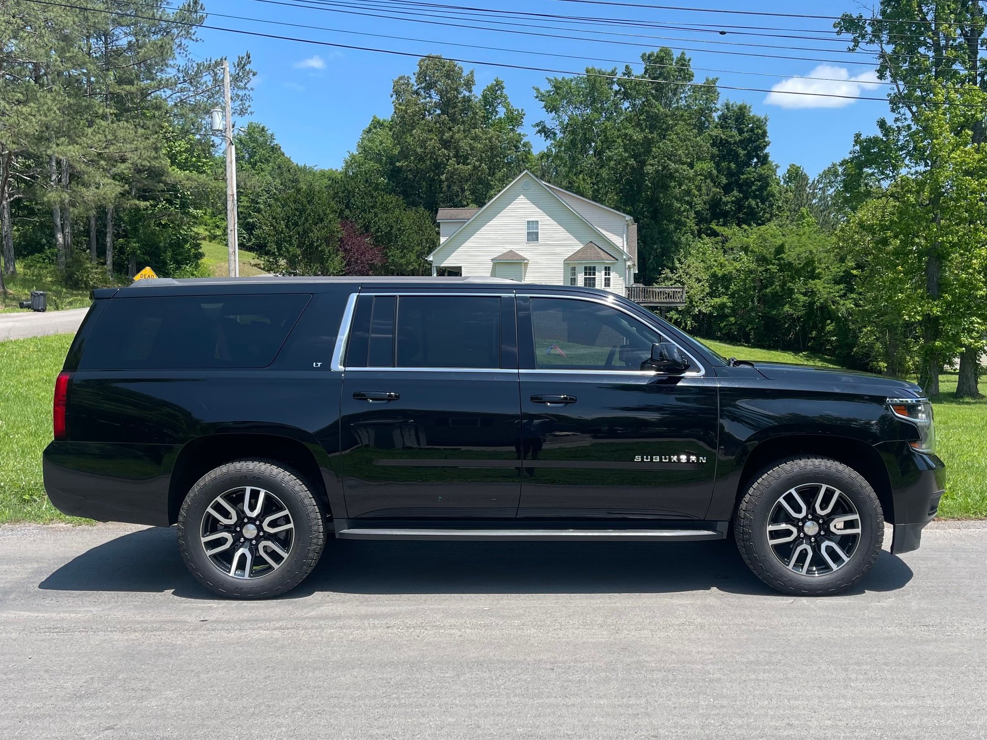

I’ve got a 2018 Suburban that I put a set of AT4 takeoffs on. They look great, but I now need to recalibrate the speedometer since I have a bigger tire size. I’ve seen a few tuners that can do it such as Hypertech and Pulsar. Both are pricey. Does anyone have any recommendations or experience with this?

How do those wheels ride? Notice any difference?
This came from the factory with the base 18” wheel with Michelins. They rode great and handled well. I’m a fan of Michelin tires though.
These AT4 wheels are 20” paired with an all terrain Goodyear Wrangler. They ride a little stiffer and there is a bit more road noise from the all terrain tread pattern. The difference is very minimal though.
This does have a 1.5” leveling kit on the front to help even out the rake and clear the taller tires.
