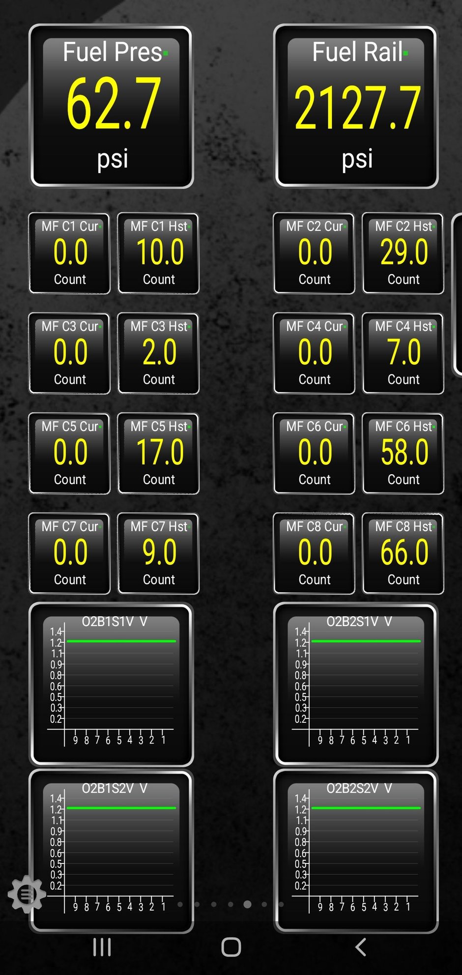

Thanks for the response. However the fuel pressure from the fuel pump looks good. The high pressure side on the fuel rail is around 2k psi. I have the picture posted with actual values

Welcome to the forum. Over 2K psi sounds a little suspect to me.

@73shark do you know what PSI level the fuel rail should be at? -this far down fuel delivery only has injectors to go through, right? Does this indicate all my injectors clogged at the same time?

With the key on and the engine not running, the pressure should be in the 50 psi range. It should be about the same or perhaps a little higher with the engine running.

2019 is a direct injection motor. Lift pump is the low pressure reading, high is the fuel rail pressure after the high-pressure pump that feeds the DI injectors.
