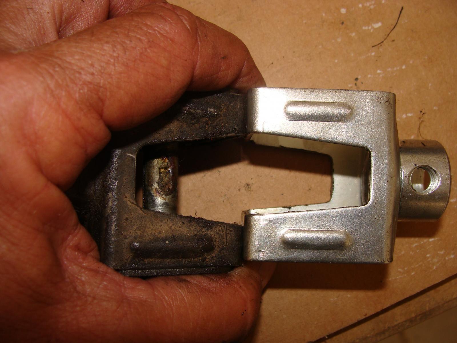

Second example: shift coupler for my 1970 VW was too small to fit over the transmission shaft. I ended up using the new rubber parts in the original steel cage.

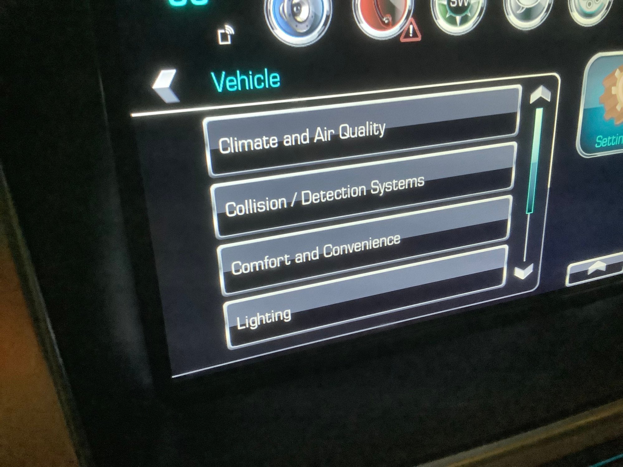

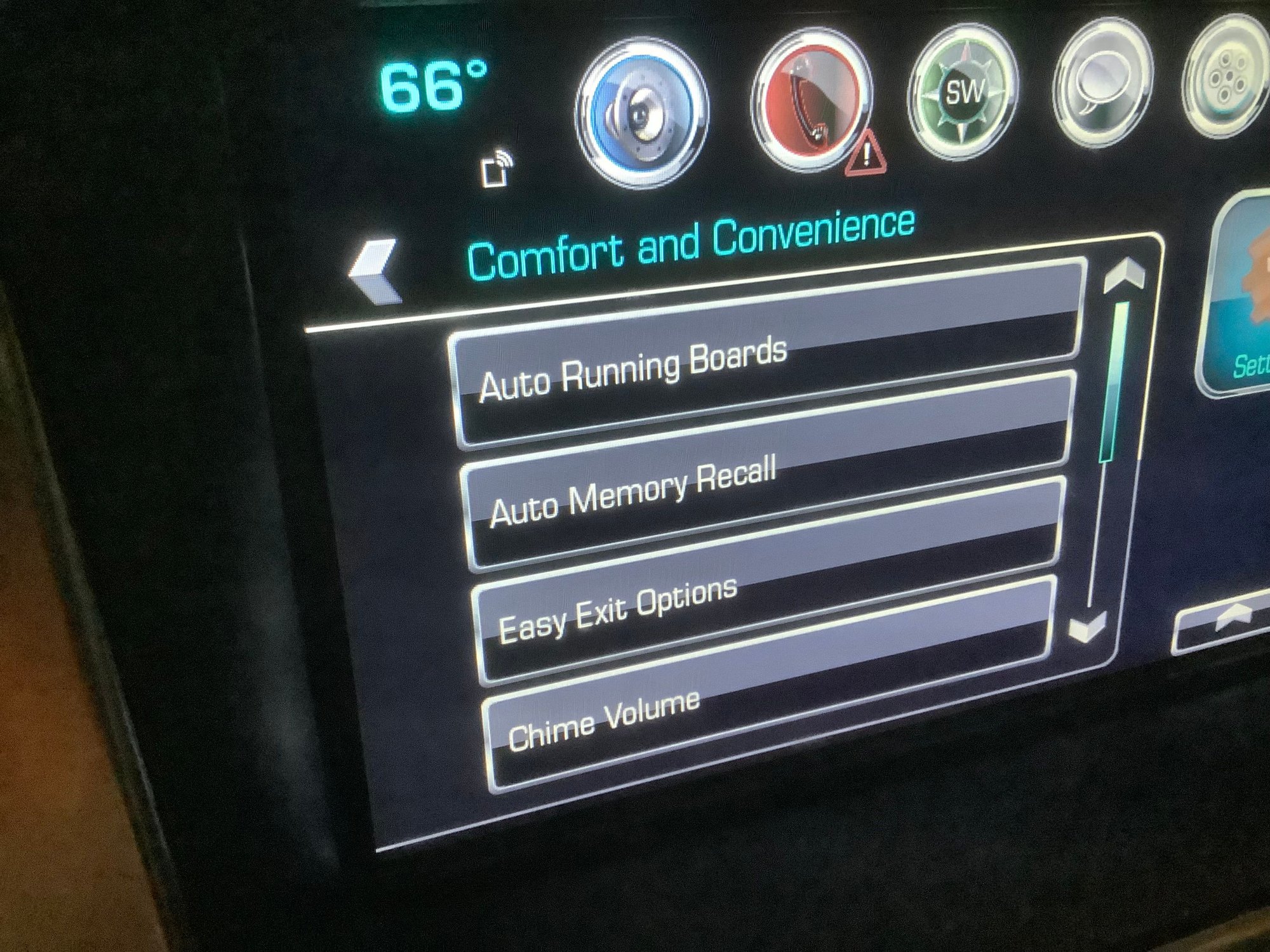

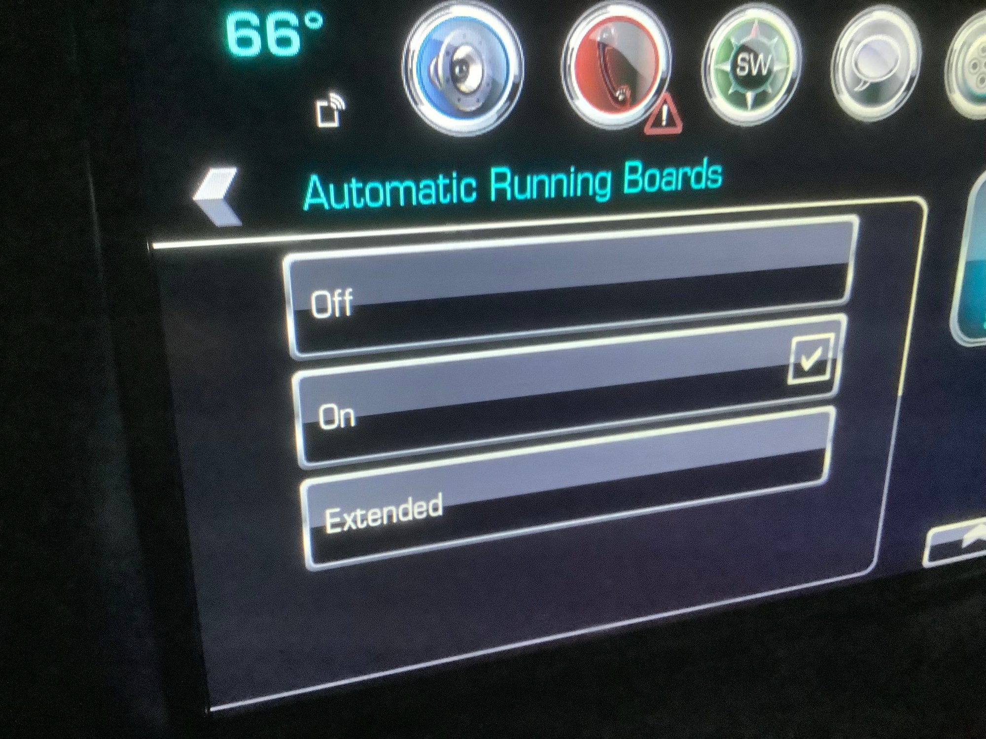

On a lark I decided to set the running board drop to extended. Maybe it is just a coincidence, but the passenger side running board now appears to work consistently.

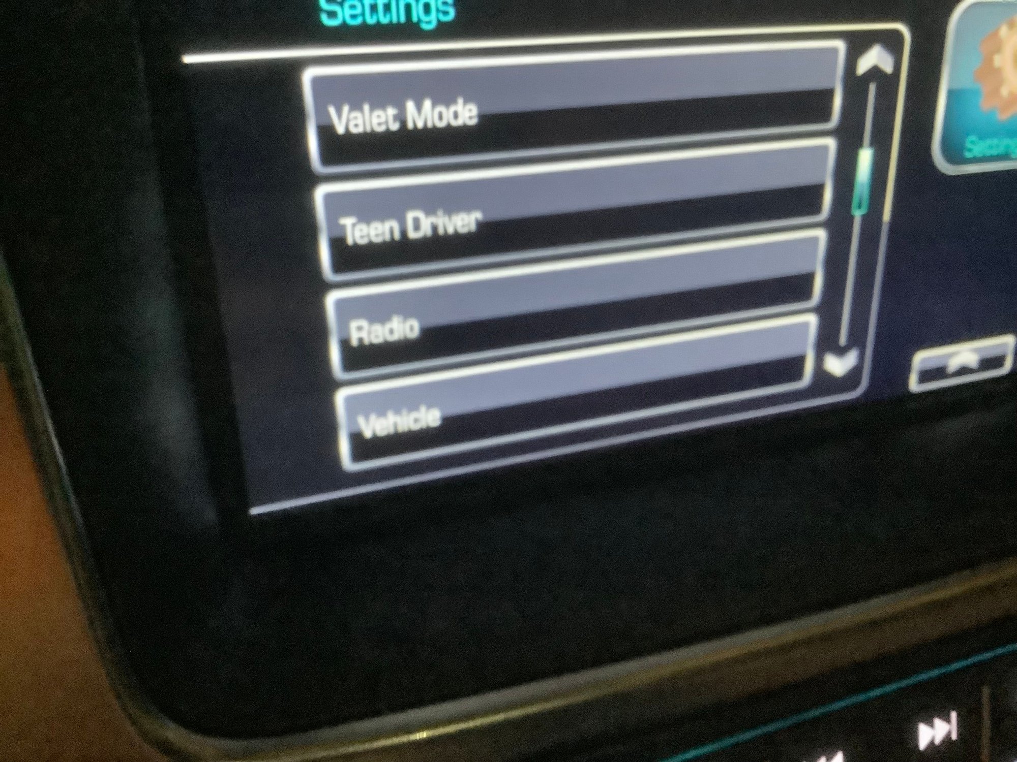

What does "set the running board drop to extended" mean? I know of no such setting for running boards. Can you please explain? Thanks.
Old Nov 22, 2023 | 4:06 PM
CarFan1's Avatar
Joined: Oct 2023
Posts: 40
Likes: 6
From: Texas, VA
It’s a menu option on the 8 inch screen.
