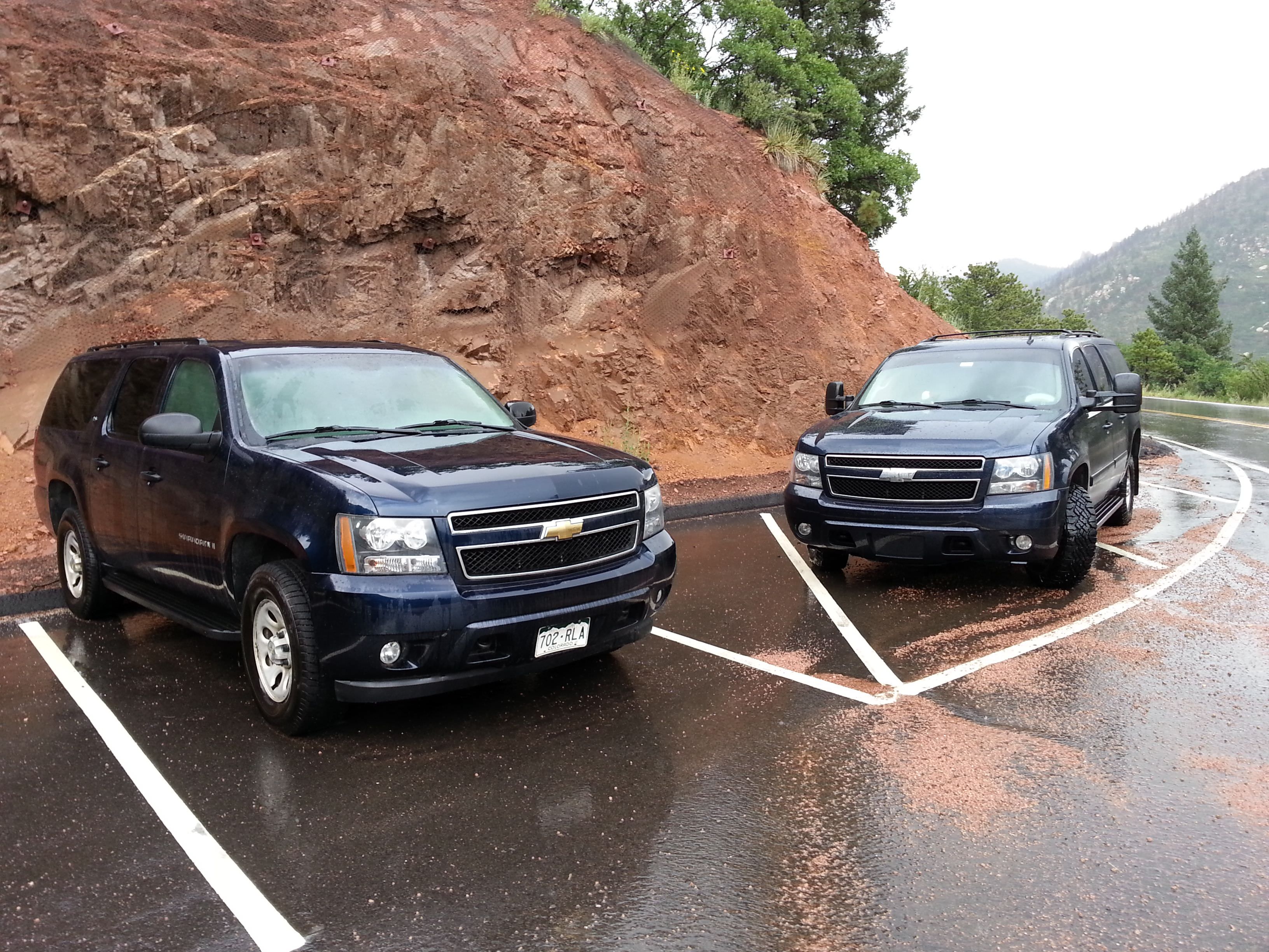

Originally Posted by sfcjones
Some government fleet models do not have the towing package on the 2500HD. They were ordered without that option as well as they are typical base models (LS)
The Suburban 2500 is not a 2500HD. It's equivalent to the 1500 HD Silverado/Sierra. The 2500HD pickups have a higher GVWR and higher axle weight ratings. For example, the 2500HD trucks get the 11.5" full floater rear axle, as opposed to the 10.5" FF in the 2500 Burbs.
And regarding the towing/cooling package, I will simply say show me a pic of the RPO sticker of ANY 2500 Suburban without it. Until then, I say you are incorrect. I looked at dozens of 2500s all over the country before I bought mine, including government vehicles. And including 9-passenger LS models with the front bench seat. They all had the cooling/towing codes.
ETA: Here's where we came upon a fleet truck the same color as mine, belonged to the Colorado BLM, the one on the left. It had the cooling/towing package. You can even see the two fittings for the trans cooler in the lower opening of the grille, right below the bowtie.
