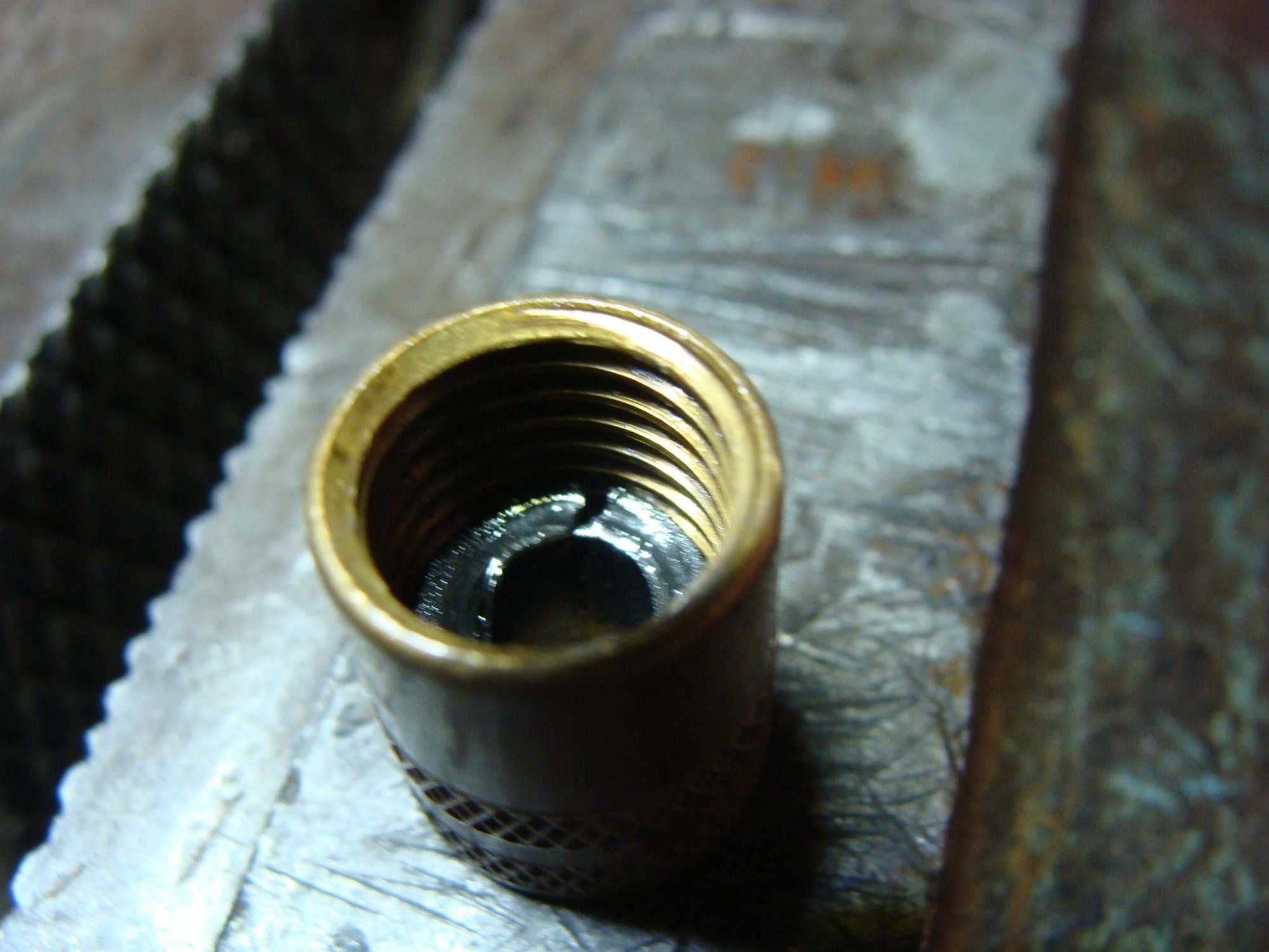

The service valves typically leak. A good cap has a rubber seal inside it, that makes the real seal.
Here's an issue I had with an R-12 cap recently, crack in the rubber seal.
