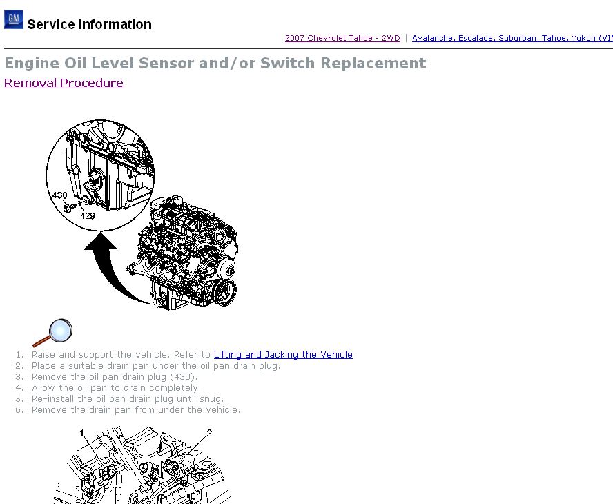

R u sure there isn't a level sensor?
Old Jan 22, 2015 | 3:24 PM
Likes: 48
There is a sensor, but it only detects when the oil has gotten pretty low....
I don't know what that threshold is though.. 3 maybe 4 quarts I'd guess
I suspect they had to placed so that various angles and dangles would not falsely activate it, and it would need to be below a level that crank lobe splash would not affect...

Posts: 11,340
Or they could shield it so it only sees the level.

They could delay the warning so that it doesn't throw a code (or warning, or whatever) unless the oil level is too low for say 3 restarts and 3 hours. This would make sure that it's not just because the person drove up a steep hill
