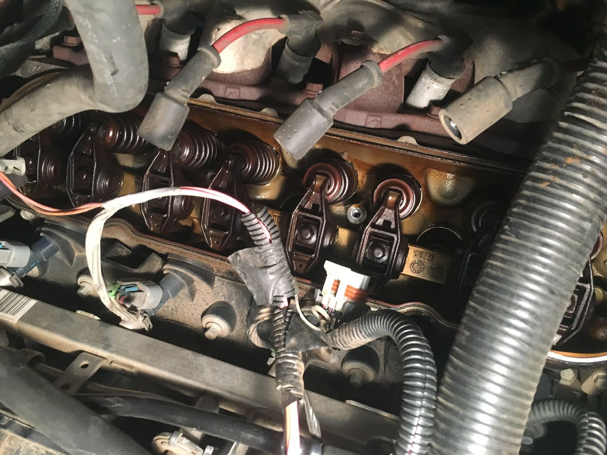

Talking UPDATE - No snake oil here. THIS WORKS!
For less than $75 for the Dorman aftermarket cover (confirmed that it's the updated version), I decided what the hell? The clouds of blue smoke at startup were getting really bad.
I have to admit - I was skeptical. A 12 year old 5.3 that had enabled AFM 80% of its life is going to tired. And it's going to consume oil. Don't expect a fix as simple as replacing a valve cover. But really, could it hurt to try? After warming up, under hard acceleration, moving after idling for an extended period of time - all the things that say tired rings and/or valve seals, it wasn't smoking at all. So maybe there's some validity to this updated cover being a fix.
The proof is in the puddin'
We'll see if the consumption goes down. Given that the blue billows are no longer, I can't imagine how it won't. Worst case, my Suburban will continue to use oil. But now it will be inconspicuous...and I'm good with that.
