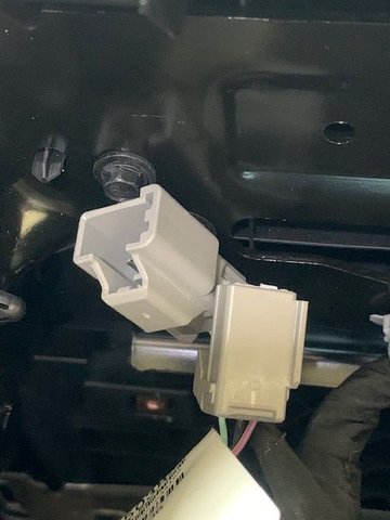

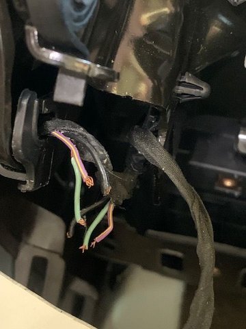

Found the following: Removed the rear console cover (4 screws) discovered wiring harness broken within lid hinge. Fuse blows each time the lid is opened/closed - also causes Sunroof to not operate. Left fuse box (drivers side) #8 10A (SEO RAP) Note: this seems to be a problem going back a number of years.
The fix for the sun roof is to unplug the wireless charging pad connector.
