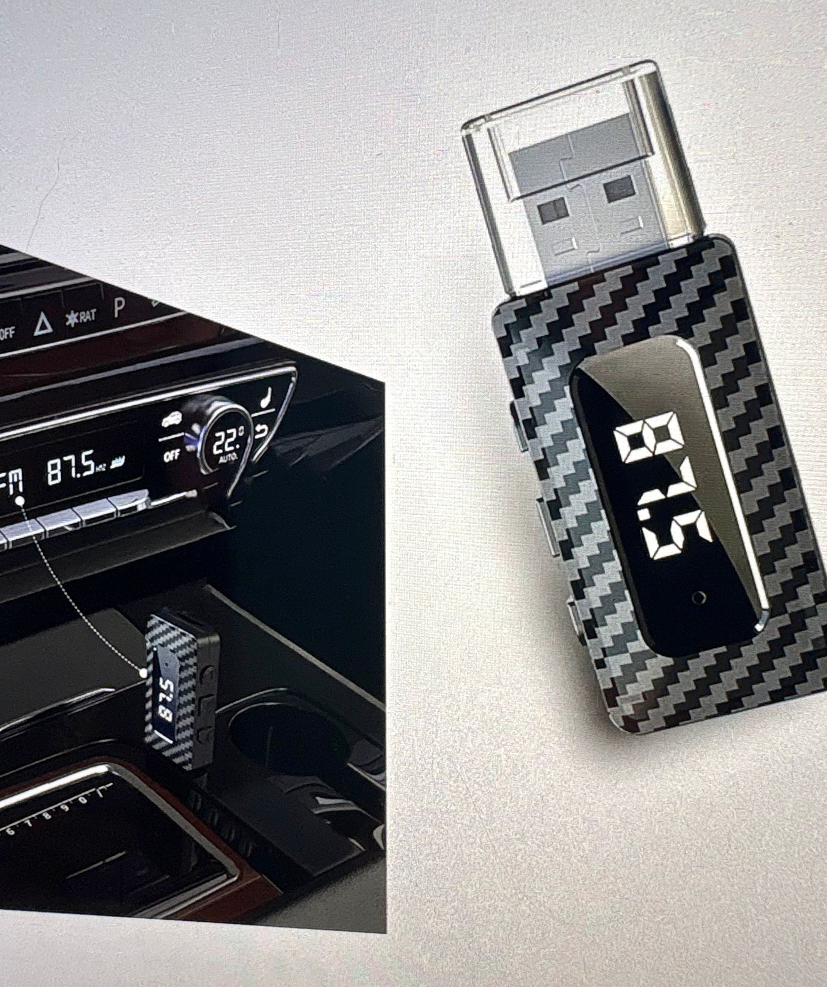

I have a phone charger that can transmit your iPhone audio to the FM radio, and it works pretty good. But you have to plug it in, and it’s bulky, and it does not do quick charge. Also, you have to unplug the charger every time you get out, or it’ll run your battery down. Eventually.

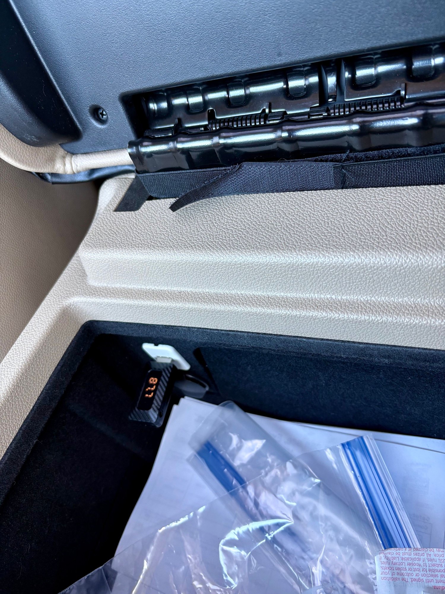

Inside the center console, there is a USB port for playing music on a USB Zip drive. So I bought this little Bluetooth FM transmitter dongle on Amazon for about $9. I stuck the dongle in that USB port, and it didn’t come on. Oh, that’s right; that USB port probably only works when the radio is on. Turn the key switch on, and the radio comes on, and the USB port/dongle comes on.
I set the frequency on the dongle to an empty channel on the radio, and turned on Bluetooth on my iPhone.
Instantly works beautifully. Comes on when the car comes on and goes off when the car goes off. Automatically reconnects to Bluetooth on my iPhone, when the key is on.
