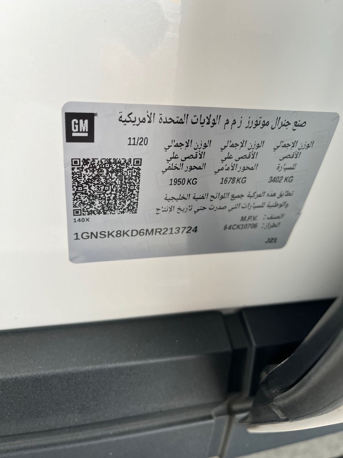

Is there an engine family sticker under the hood? That sticker usually exists. Also look for DOT on all the glass and all the exterior light lenses.
Other than maybe the headlights everything should still be DOT approved. Some headlight housings are different for EU specs but the rest should be the standard DOT parts.
Drivers' door jamb sticker may have some useful info also.

No, oddly there is no sticker whatsoever under the hood... There might be under the plastic coverings, but I assumed the dealership would know if there are. There is none of the stickers that you get if you buy the car in North America though. The below is the sticker in the door jamb. It basically states (from what google tells me) that the car has been manufactured to GCC (Gulf Country Specs) and information similar to the one found on the NA VIN sticker.
