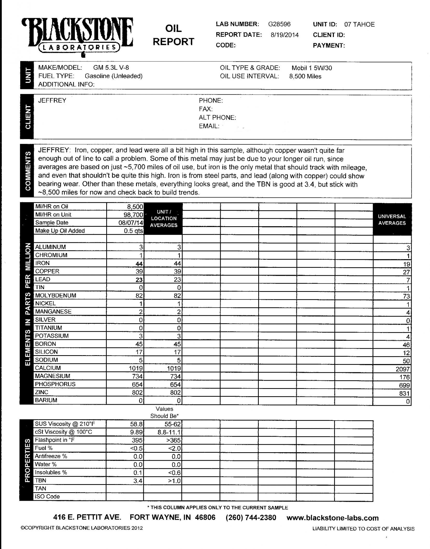

As promised here is the report back from Blacktone on the evaluation of my Mobile 1 oil use and the ~8000 mile oil changes...
In a nut shell I can continue with the ~8k mile oil changes as the oil is holding up well in the TBN however I am getting high iron and lead...
They did not speculate as to why, so I emailed them back to see what their opinion was on potential AFM lifter wear causing the high iron, I'll follow up with the response when/if I get one...
Recap:
2007 Tahoe with 5.3L flex fuel
98,000 miles
original owner
M1 synthetic since new
cost was $25 +10 for the TBN (how is the oil holding up) $35 total the sample vial and mailer are free, shipping the sample back was ~$2.80
Would I recommend this, as a once a year preventative maintenance item and if you are into data like this, yes I would.
Here is their site if you are interested in what they have to offer..
Blackstone Labs

About to do another oil change and send my sample in to Blackstone... on of their recommendations was to try a shorter change interval and have it re-evaluated... I am at 5055 miles since the last change...

Let us know what they say. If I recall you were starting to have some oil consumption issues.

fishing nut will do on the follow up of what Blackstone reports, I wasn't seeing consumption issues at least not with this thread post, but was seeing higher metals in my oil per the last evaluation Blackstone did for me, they suggested a shorter oil change interval and having the oil reevaluated again.
My original sample with M1 was at about ~8000 miles, my latest sample is at ~5000...
Something else I have been doing is placing neodymium, or hard drive magnets, on the outside of the oil filter to assist in trapping metals there as well...
I now have 103,055 miles on her...
I have mention consumption in another post that I just started seeing that I suspect is related to AFM see this link https://chevroletforum.com/forum/tah...e-range-70463/

Results back from Blackstone look better with this report using a shorter oil change, went from 8,500 to a 5,000 oil change with M1, I also had added a neodymium magnet to the outside of the oil filter at the last oil change so that could have helped the iron reading but the other metals also dropped like lead and the magnet won't affect that.
I would be more suspect of the oil filter needing to be changed rather then the oil itself... this has been mentioned in other post as well...

Interesting. Gonna try a filter only change at the halfway point?
