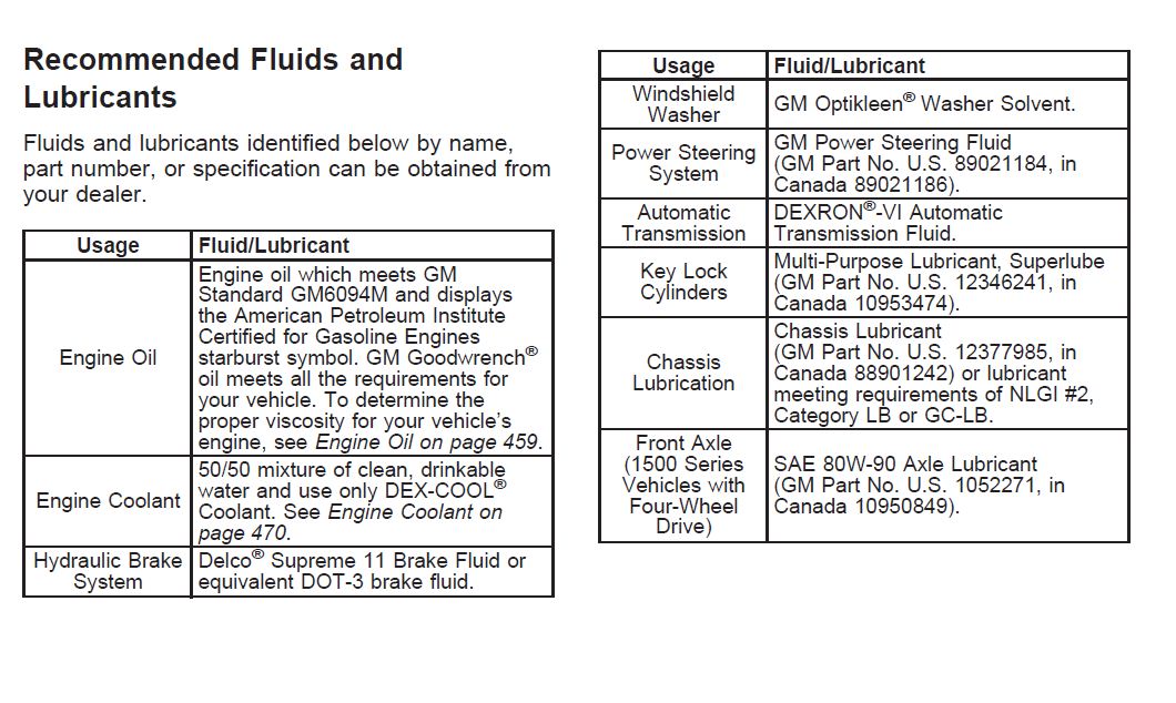

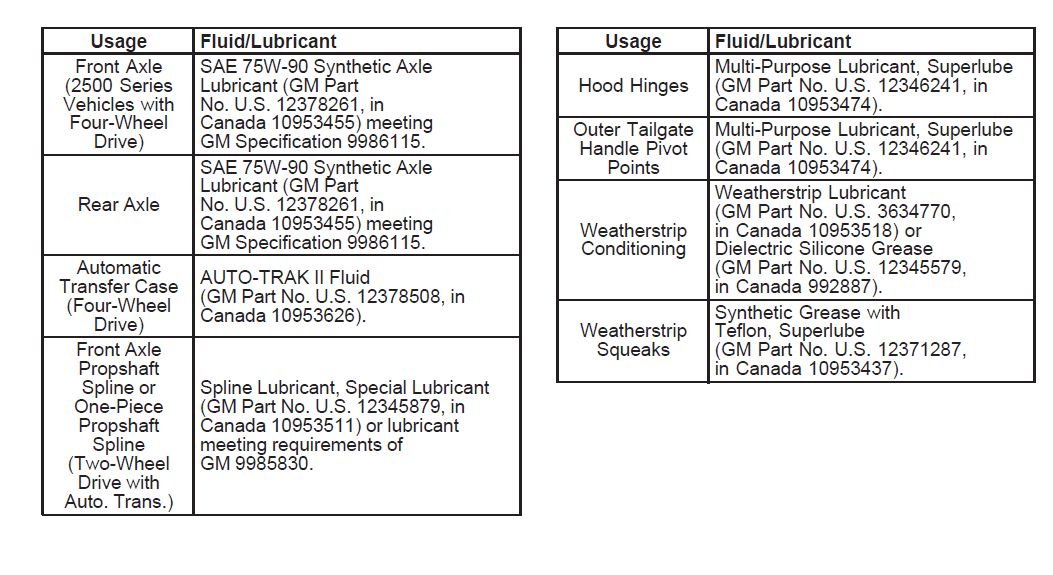

I'm getting some conflicting sources on the required fluids for the following components. I am getting ready to make these changes and want confirmation that these fluids will be correct:
Front Diff: 80w90 with GL-5 (doesn't have to be synthetic)
Rear Diff: 75w90 Synthetic
Transfer Case: Auto-Trak II (another manual says to use Dexron VI ATF)
The vehicle is a 07 Suburban 3LT 4WD.
Thanks.

Old Nov 18, 2010 | 9:06 PM
Likes: 48
Should you not have your manual available...
Attached Thumbnails Fluids for 07 Suburban LT 4x4-capture.jpg   Fluids for 07 Suburban LT 4x4-capture2.jpg

Well those are from the manual but the Haynes shows ATF in the transfer.
I purchased the above fluids today along with some coolant for the a flush.
Thx.
