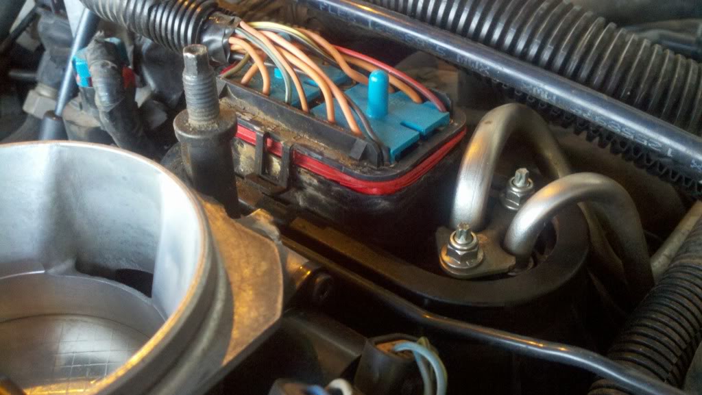

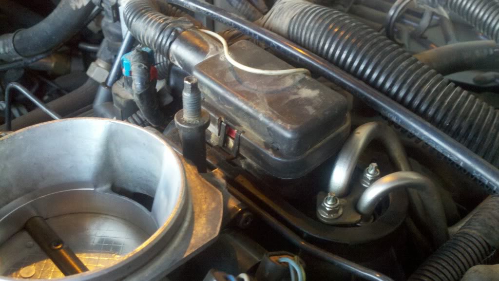

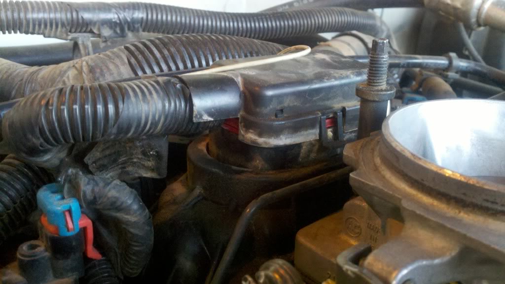

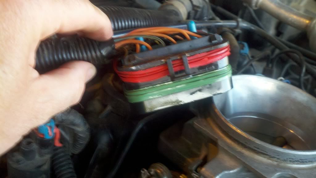

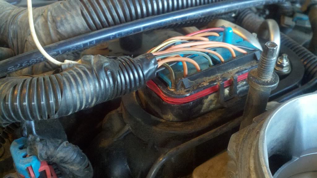

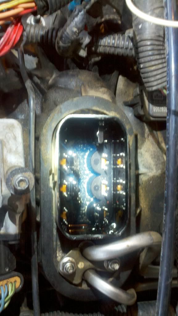

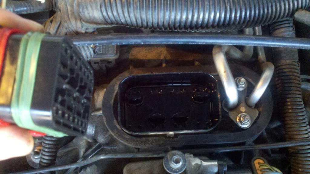

The fact is though if you are talking about what I think THERE SHOULD BE NO FUEL THERE. Hopefully someone else that has done the job before will chime in since you seem like you do not believe me. The new seal will fail also since it is not designed to stop a fuel leak. You stand a chance of fire, you have raw fuel leaking into an electrical connector that has many power and ground wires. As the fuel starts to push it off again it could spark, then boom. Call the dealer guy and ask him how many of those seals he has sold in the past.
Old May 15, 2012 | 9:22 PM
  #12
1BDDELX's Avatar
Joined: May 2012
Posts: 13

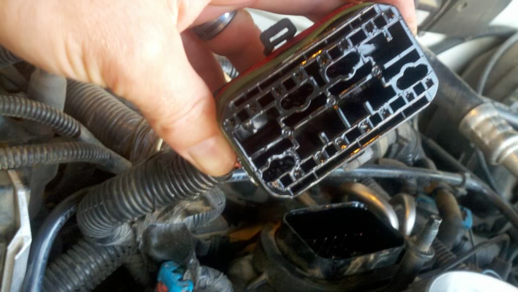

Man oh man I just ripped it apart to take a closer look and you are indeed correct....Insert 4 letter explisive Looks like I will have to change to entire spider. At least the plug isn't a total waste one of the tabs wont stay clipped anyway. Im putting pics up right now

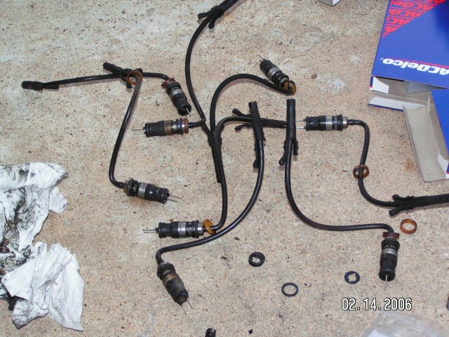

Old May 16, 2012 | 8:36 AM
  #14
Likes: 48

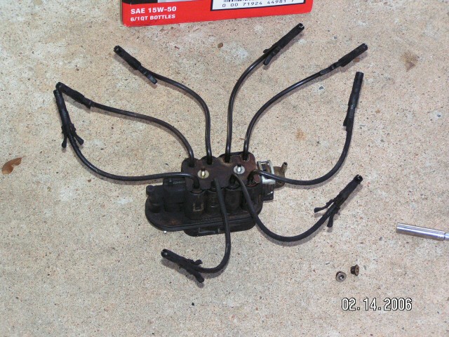

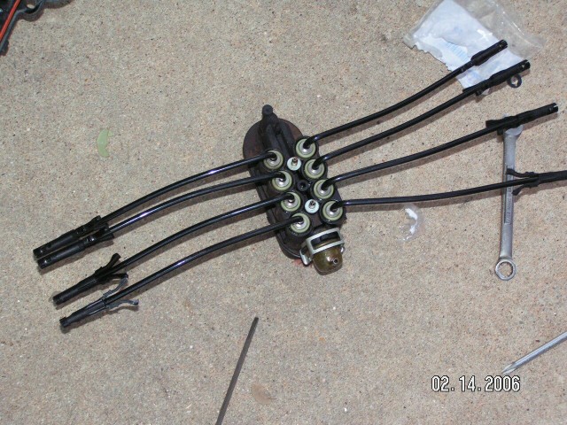

looks like the injectors are leaking or are coming apart....you will need to replace the entire fuel metering body components injectors, poppets, and regulator...been there done that...
Its not a hard job just take your time....check the body for any cracks replace if any are found...
Thanks, yes I have already ordered the entire spider complete, upper intake manifold gasket kit, and a fuel injector gasket/o-ring set not sure if I need that or not but ordered it anyway. It doesn't look very hard to do just some time I hope. Are there any other parts I need to order to do the job or change while in there? Thanks
Well I pulled the spider out and nope I don't need the fuel injection o-ring kit. Thanks for your guys help I took some pics along the way. The new parts should be here Friday.
