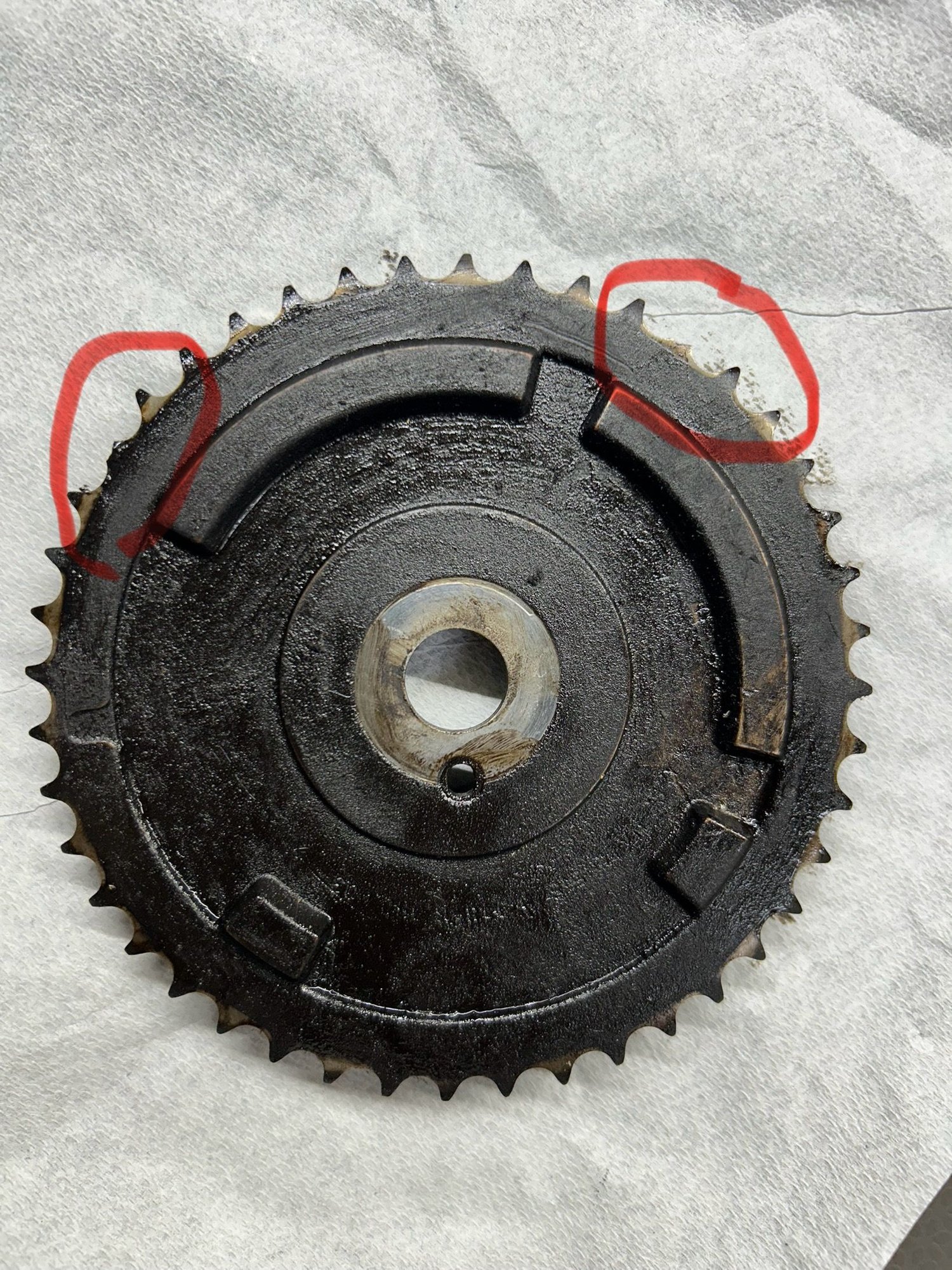

Tore into it more looks like the timing was off, there’s slack in the chain one of the plastic guides was broken and 2 teeth on the cam gear are broken off. I can’t believe it was still running and the compression was higher that normal.
