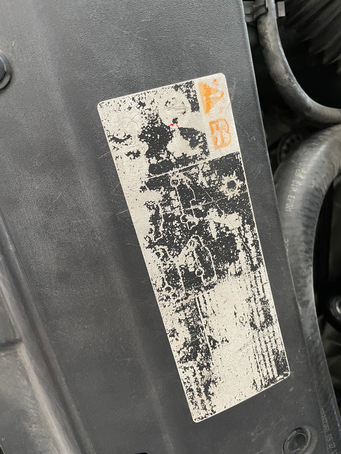

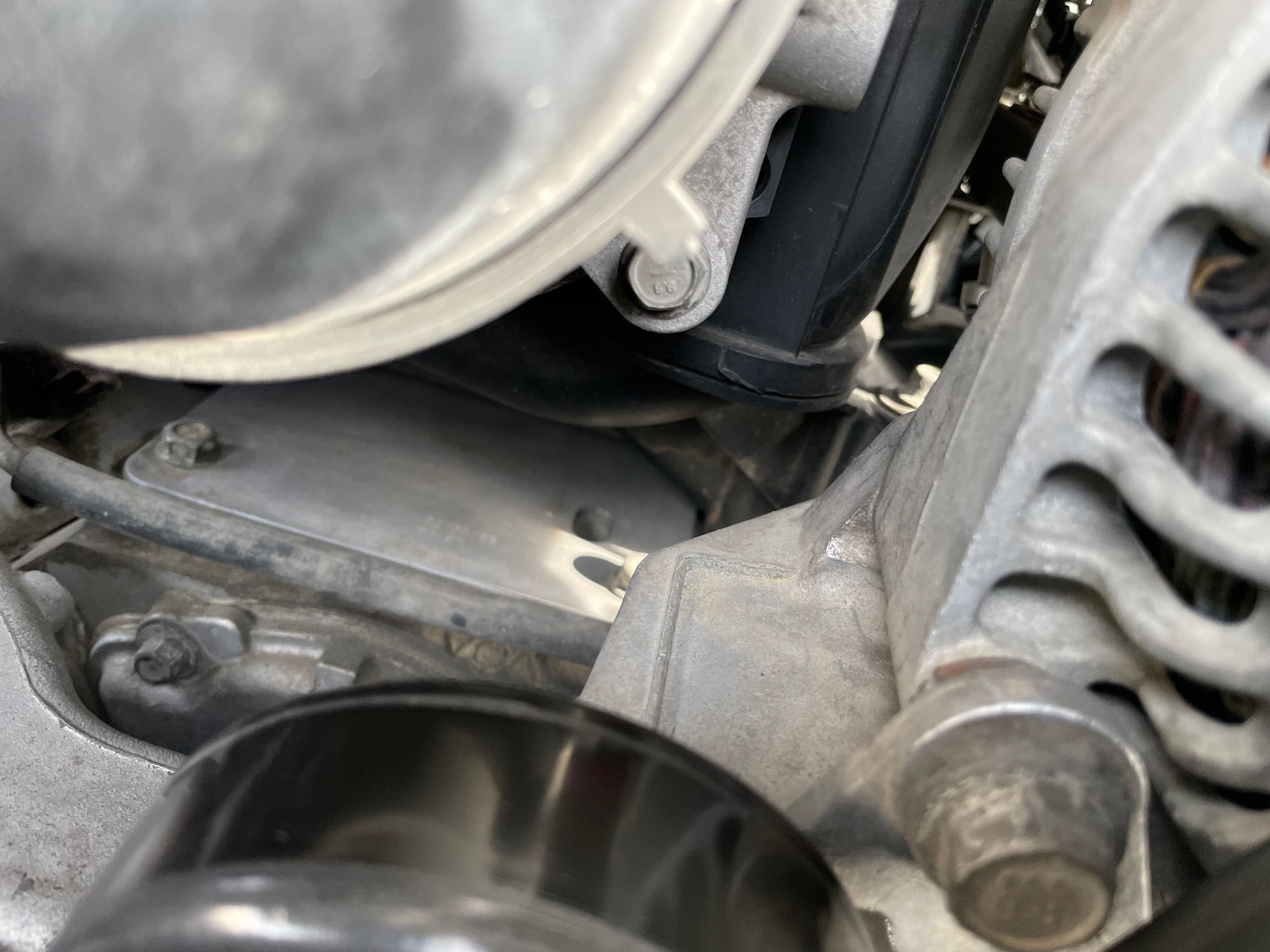

what is the engine size listed on the emissions label in the engine compartment. if its not a afm engine from factory,,,it won't have a relief valve inthe pan. post a pic of the valley cover as they are different non afm to afm engines.
post the 8th vin character.

Thanks for the reply. the 8th digit is 0(zero). And I’m sorry I’m not so good with these terms but i hope these are the things you asked for:

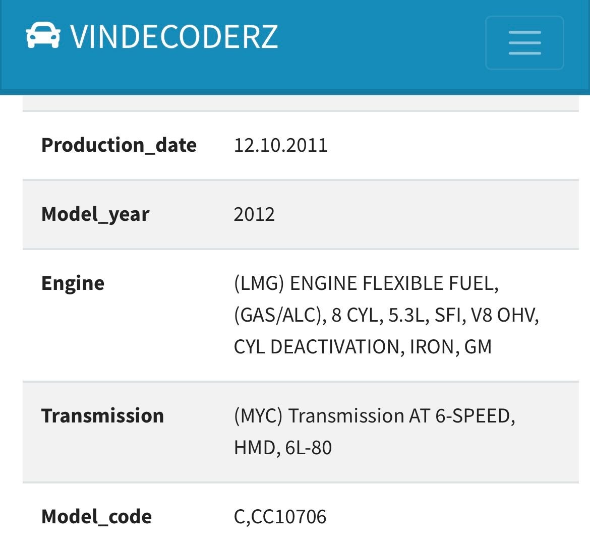

the engine in the pic is not an afm engine ....the valley cover in the pic is flat. afm valley covers are have grooves. do a vin decode in the tools section and maybe it will tell you if afm was a factory option.
if the engine was changed to a non afm engine....would not bother me at all...in fact i would prefer a non afm engine....less to go wrong.

Thanks. i tried the above but without any luck but i managed to get it from another decoder and its as below with cyl deactivation that’s with afm right?
Old Dec 20, 2021 | 10:51 AM
yes...
