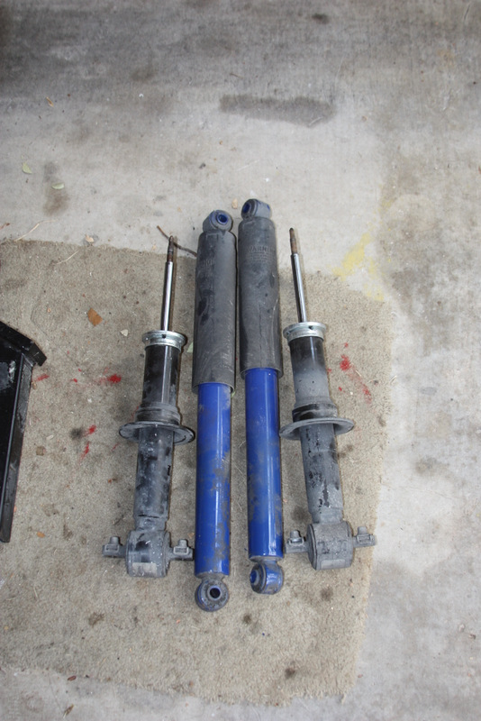

Quick struts are on. Went with monroe rears as well. The reflex ones. Definitely rides better, had somebody instal them for us. Family friend. Did front and rear shocks, plugs and changed out all fluids. Front struts came with black springs. Looked like paint not totally sure. Time will tell if they are any good.

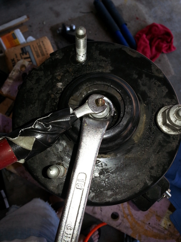

6mm open end wrench (taped inside a 1/2 pipe for leverage) to hold the strut shaft from spinning while top nut was removed.

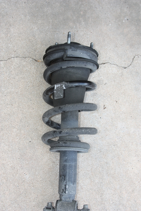

1-Old strut before removal

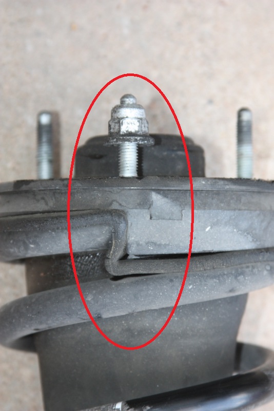

2-Old strut note coil position and alignment to stud

5-Old strut with nut put back on to mark orientation

7-18mm crowfoot and 6mm wrench taped in a piece of metal pipe for leverage

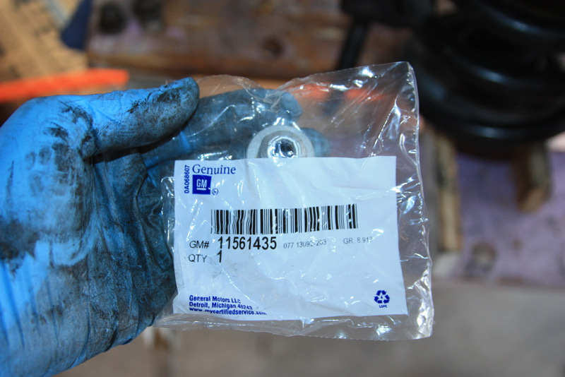

10-New strut nut is called out in service manual, my struts did not come with nuts included, had to order separately via dealer..
