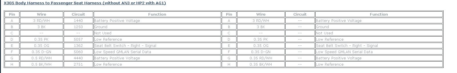

Hello alll. Im a newb here on this forum and I hope someone can help me with some info on the Tahoe seats. I have a set of black leather buckets and a 2nd row bench seat I picked up to put in a Bronco I am putting together. The seats are 6 way power seats with the manual lumbar wheel and my question is regarding the wiring and fuse sizes. The passenger seat has two wires going to it so I assume that these would be power and ground so probably an easy wire. The driver seat has 4 wires going to it so this one is my concern. So specific questions are:
1) Can I just run these seats with just power and ground?
2) Why is there 4 wires on the drivers side if all the controls are integrated into the seats? Is this for a user memory profile option via CAN or LAN? The passenger seat has a large pink/white stripe wire and a black wire (I am assuming the pink/wht is power and black is ground) and the driver seat has 2 large pink wires, one on each end and then has a small white wire and a small pink wire in the center. No idea or guesses on these wires. Any idea how to wire the driver and passenger seats?
3) Can I just run these seats to battery through a fuse and if so, what size fuse is recommended?
4) Last question. If I get to point where I decide I dont want to cut up the frames and decide to sell these, what is a good price for the buckets? They are literally like brand new as I got them from a wrecked vehicle with less than 2,000 miles last winter. It may be easier for me to sell these and just find a newer Bronco seat set to place in the vehicle from a mounting standpoint.
Any help would be appreciated.

I have tried the search option and I am not finding anything about this. Am I doing something wrong here as a newb on this forum or is this too complicated and I need to just buy a helm wiring diagram for the Tahoe and figure it out? I was hoping someone on here may have access to this info.
If I am doing something wrong here please let me know so I can correct myself.

I only have access to a 2009 seat but give it a try and see if it makes sense with what you have....
You might get a good price selling them through this forum as for price get at least what you paid for them....
