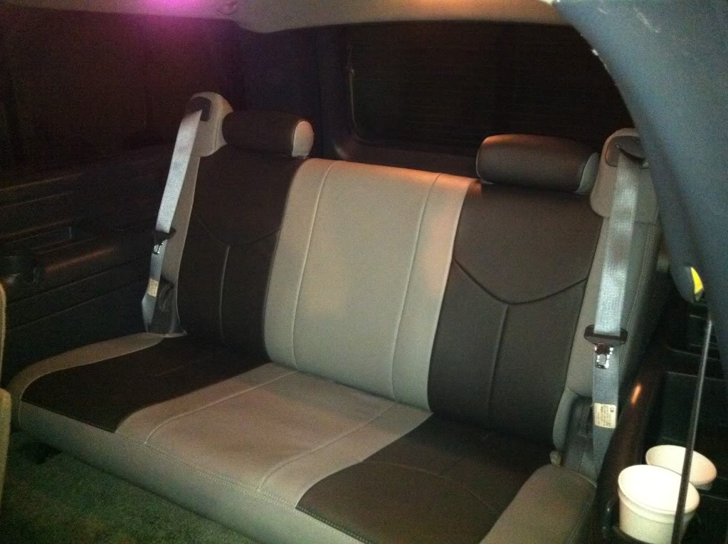

BEFORE: (shoulder retractors in place but missing buckles and center lap belt)

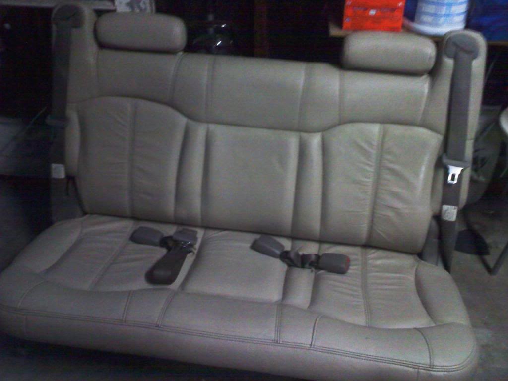

Example of OEM: (buckles and center belt routed thru cutouts in the leather seat)

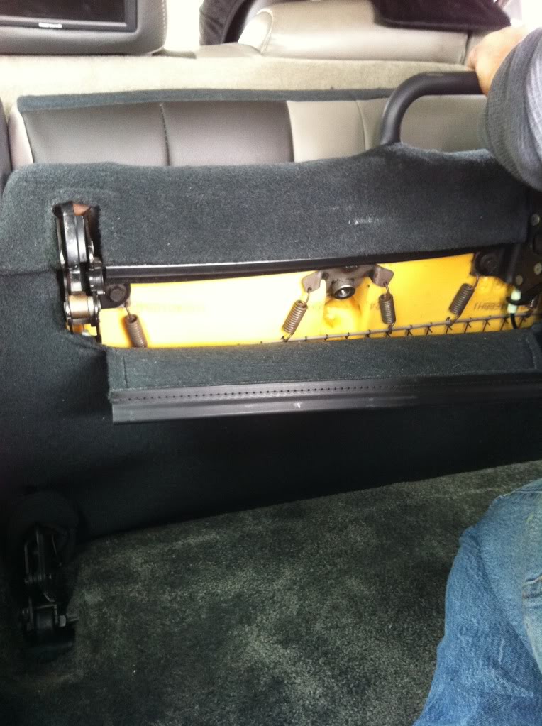

From underneath the seat, one of the holes to mount the belts:

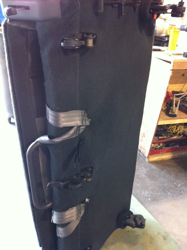

Mounted from underneath:

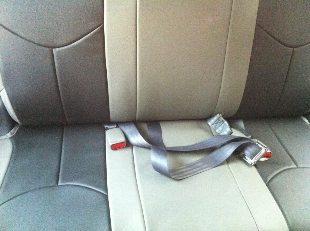

Clean install all DONE!
