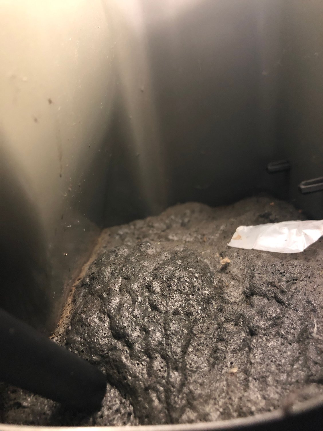

Old Jun 13, 2020 | 6:25 AM

Default C Pillar Drain

****Aloha, where does the water drain? Straight in to the NVH foam or is there a port there somewhere? Do i just let the hose hang 1” above the foam and it drains into the foam??? Thank you so much for your help!
Nvh foam at bottom of c pillar
DC pillar drain hose
