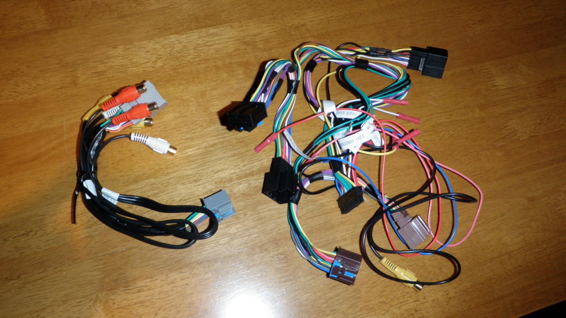

1. Order the Lockpick Harness from this place: http://tvandnav2go.com/contact.html
I am not endorsing them (ad), but they were the ONLY place that would sell me just the harness and not the whole damn thing. Costal tech was real bi*ch about that....

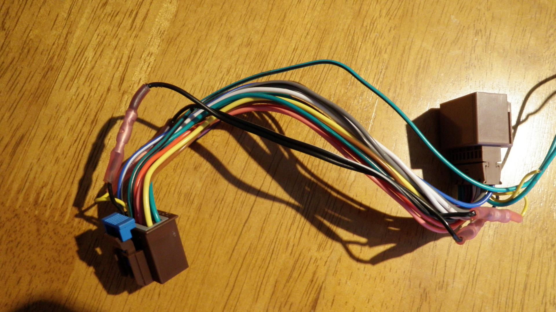

2. Seperate out the connectors you will need from the rest. You need the brown to brown one. You will have to cut some wires here! Be careful, you only have so much to work with.
3. Since we are not installing the lockpick, you will have to create the wires between the backup camera and sat nav, I used small speaker wire, it worked fine.

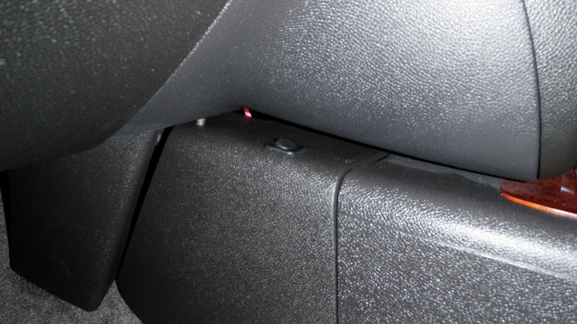

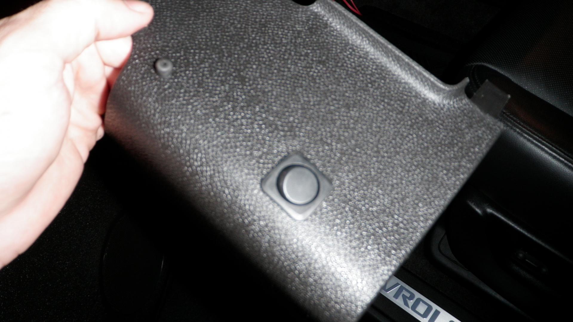

4. You are adding a switch to the 5th wire in, from GM it is green/white, on this harness it is green/black. (see pics).
5. place the switch whereever, but I'd keep the run short since I don't know if impedence will affect the operation.
6. The theory is that opening the switch (off) will make the headunit think you have stopped.
The REALITY on my 2009 is that it will think you have stopped, but only for about 30-40 seconds. THIS MEANS, while driving, you flick the switch 'off' when on the 'dest' screen, enter the city. Flick the switch back ON for 5 seconds. Then OFF to enter the street / number, then ON to resume normal ops.
