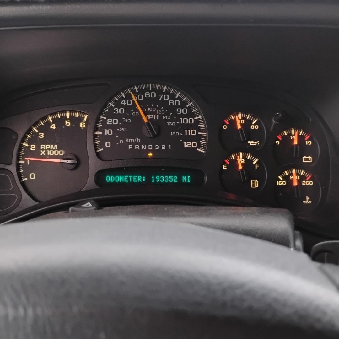

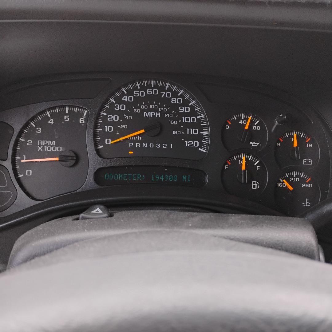

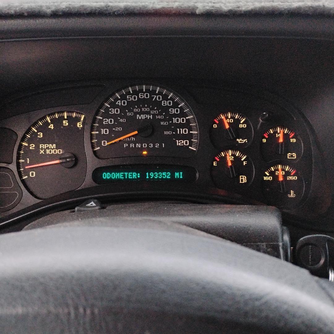

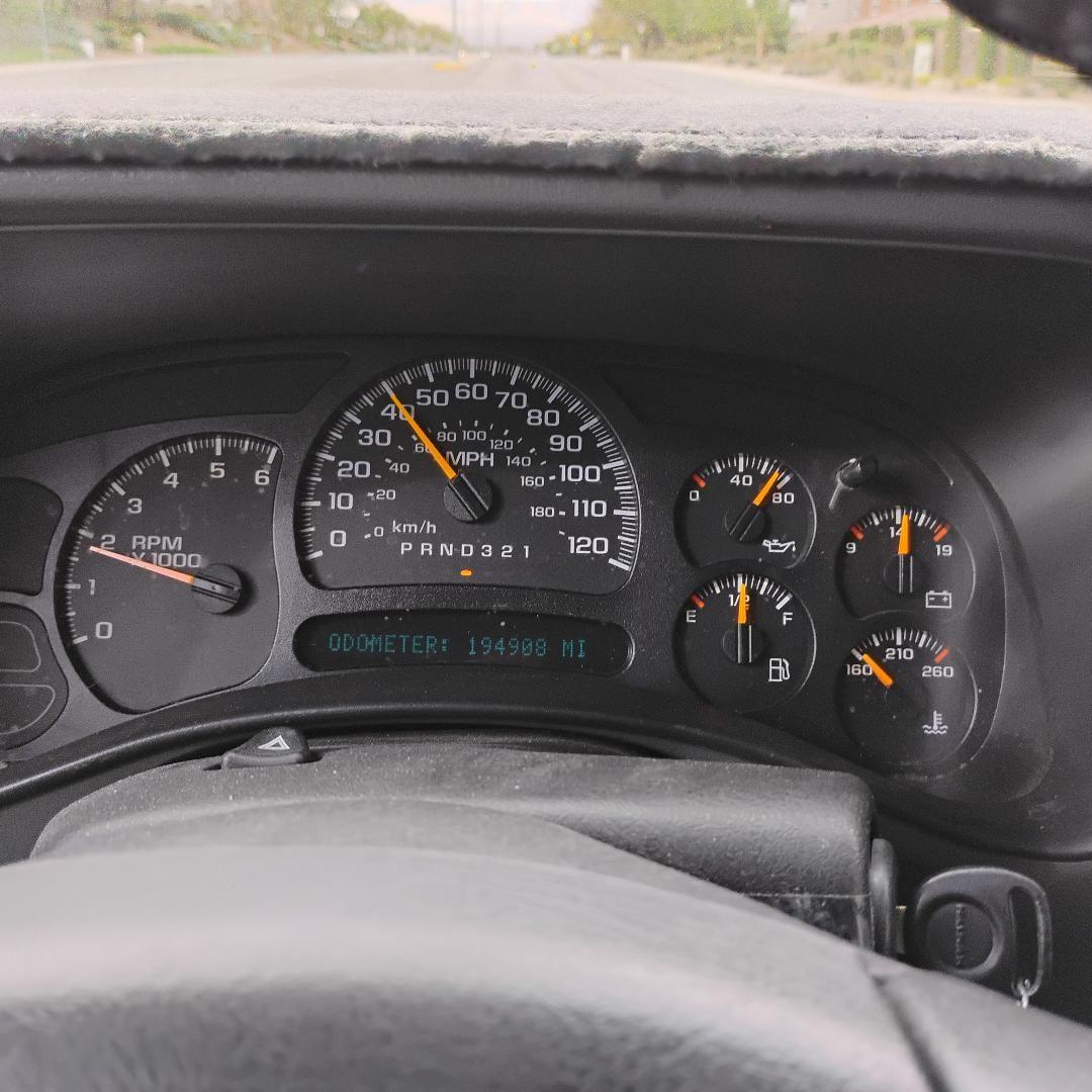

A while back I started to get lower oil pressure on my 2006 5.3. It used to run right around 40 psi at cruising speeds. It had dropped to 30-35 at speed and 15-20ish at idle. Then it statrted to get slow oil pressure build up at start ups. So much so that my low oil pressure warning would chime. I did increase oil weight to 20w/50, and it did help, but after a few thousand miles I could see it was slowly getting back to low. At the point of needing an oil change I was contemplating whether to have the oil pan dropped to do the pick up tube O-ring. After some flip flopping I decided to have the whole job done and replace the oil pump too.
So glad I did. Oil pressure is great and my intermittent lifter tap is also gone.
Before oil pressures
After new Melling HV pump and pick up tube
