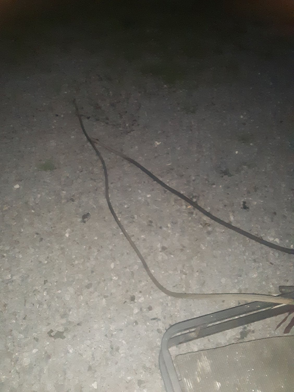

I just pulled the hoses out of my 92. They are not the greatest quality. Barely better than heater hoses.. if you know anyone who works around heavy equipment, try to score some hydraulic hose. Never have to deal with hose problems again. You have 2 about 17 ft long and old too. I use hydraulic hose for any replacement. My booster hose is rated for 3500lbs 😁
