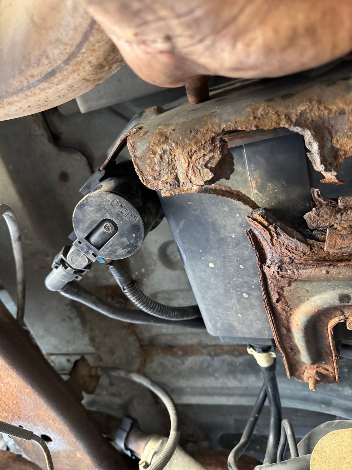

This is under my 2005 Z71 Suburban directly in front of the spare tire. I am trying to locate a new, less rusted bracket but I have been unable to locate one or even what this bracket is called. Any help would be appreciated. Thanks...

Welcome from Florida. You can try the junk yards. Your picture doesn't show the entire bracket. You can also possibly make one from a piece of metal.

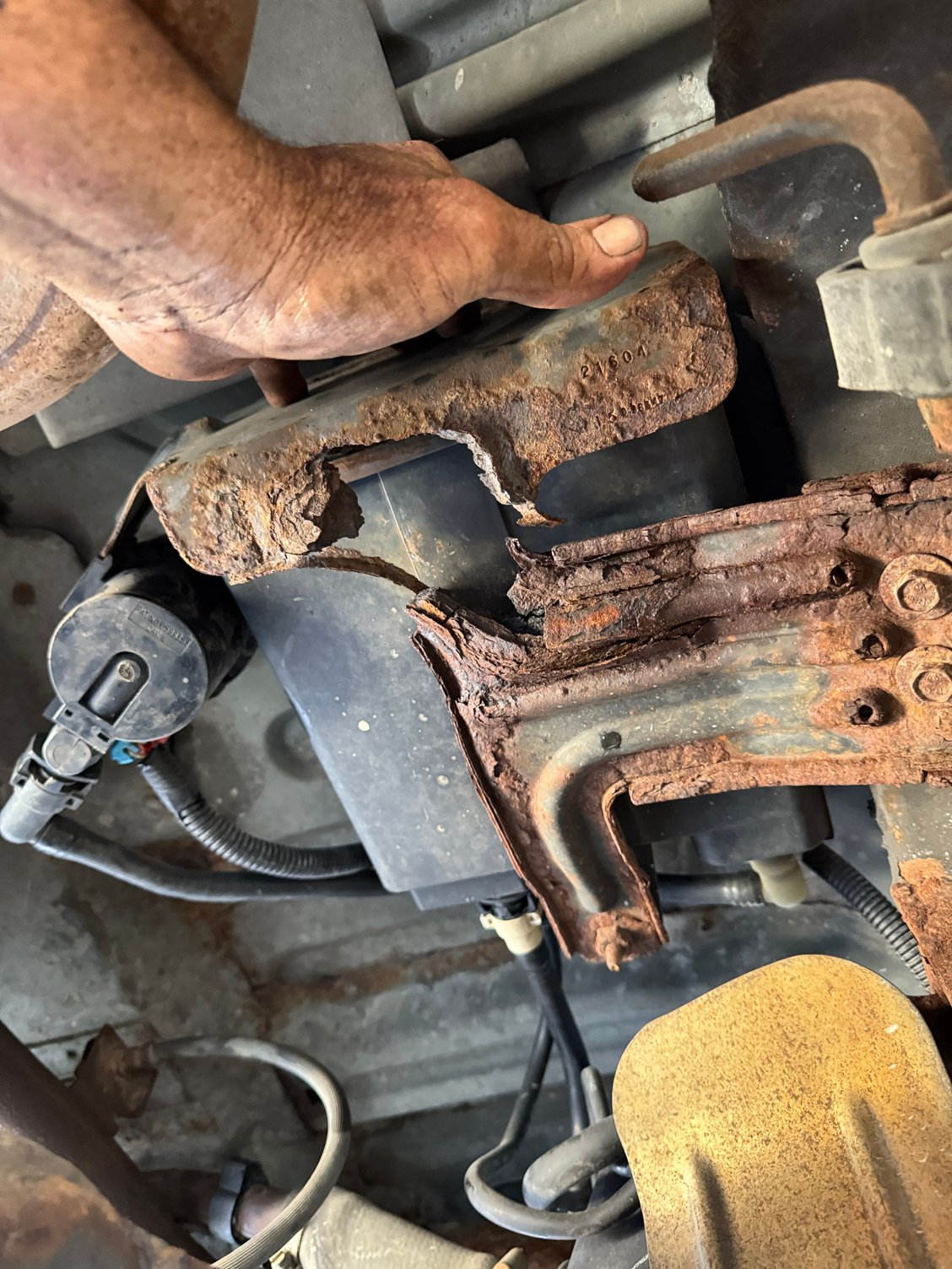

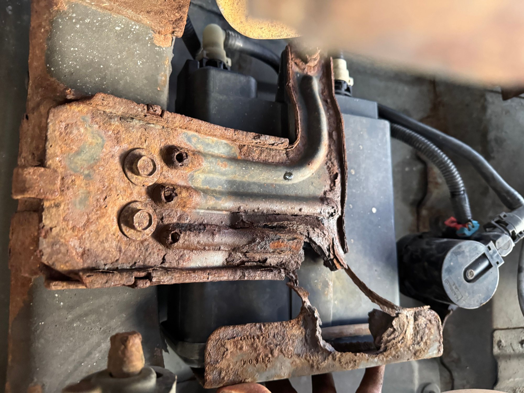

Here are some more pics of the bracket... What are these items being supported by this bracket???

the square box appears to be the EVAP canister (if it has several hoses going to it). The round thing with the wire and hose going to it is the EVAP vent solenoid.
On the pickup trucks this is farther forward, near the front of the bed, near the front of the gas tank. But I guess now that I think about it, it was just in front of the spare on my old Yukon. The SUV's orient the gas tank and related equipment differently.

Thank you... I am looking for part number
ACDelco Vapor Canister Bracket - 15088347

Good luck finding it! I found a few sketchy websites that would let you add it to a cart, but most of the reputable parts places say not in stock, or discontinued.
This might be something you have to look for on eBay, from salvage yards. You are likely up north, where rust has eaten up the bracket. Down here in the south, where road salt is not a factor, everything under most of the trucks and SUV's is still useable.
