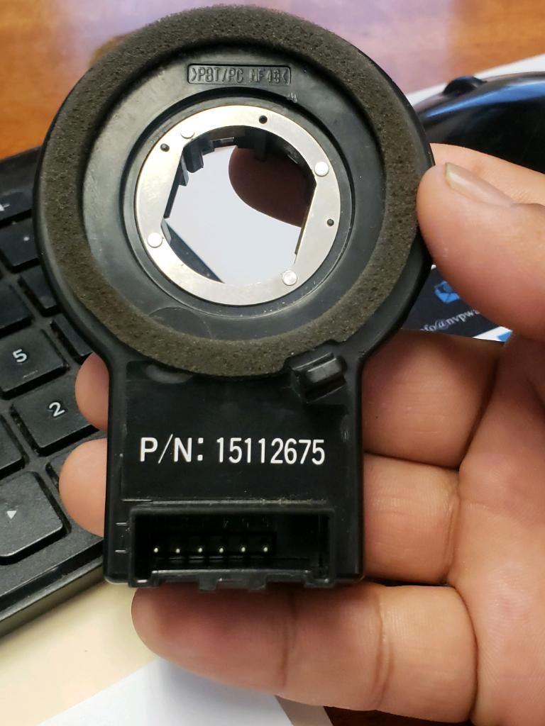

Default Yes I got an answer
[QUOTE=blackvtr;434513]
Originally Posted by RJK
2007 Suburban 5.3 LTZ
Started up the burban tonight and I have Service Traction Control - Service Stabilitrak and ABS light is on, I'm sure they are all related any ideas?
I searched and found something about a dealer computer upgrade? Does this fall under my 2007 powertrain warranty?
Thanks
its a wire on one of your wheels, push the clips togthertogether
Yes they are both related Indeed- I got mine fixed- the part is called the Steering Angle Sensor- it’s a prep design- you will see that most places that sell this are out of stock -even the dealer will tell you that you have to lie with it because that particular part is discontinued- they won’t tell you that In fact they redesigned the part and I think they are on all Tahoe,Suburban,Escalade Etc. The new design has 8 pins in it— the part we have in there has 6 pins—(not to get this confused with the spiral pin that is sticking out the new part THAT SHOUKD NOT BE REMOVED UNTIL IT IS PROPERLY IN PLACE AND MOUNTED- or you will spin it out of whack and therefore ruin a brand new part by throwing off the calibration— 9 times out of 10- if it is not one of your Hubs/Bearing or Speed Sensors on your tire which reads the turns and calibrates— then it is your Steering Angle Sensor— the new 8 Pin WILL FIT INTO YOUR CURRENT 6 PIN HARNESS so no need to panic-this can be done yourself— be absolutely SURE TO MOVE UR SEAT BACK AND TAPE THE HECK OUTTA UR STEERING WHEEL TO NOT MESS UP A SPRING OR THE SAME PART AGAIN—- YouTube it— like ALOT— youlll learn more and more about this part—after changing? No need to reset any lights— the Tahoe started up and read the problem was solved and fixed itself—
SELF CALIBRATION OR TAKING JT TO GET FLASHED OR CALIBRATED INTO YOUR SYSTEM IS NOT AN OPTION— the part is roughly $159 at the dealer- don’t cheap out and go after market or you’ll likely be doing this situation again in a few months/ I’ve ordered aftermarket and it was actually too thick and I returned it and bought the dealership one with the 8 Pins - plugged right in— get a BlueDriver obv2- like 99$ and will tell you what EXACTLY is your problem in this situation m- they are great I mean GREAT tool..
