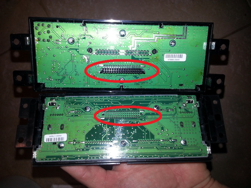

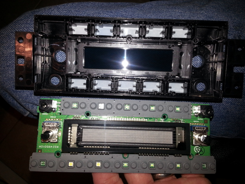

So I pulled the RSA (Rear Seat Audio) control and disassembled ( see pictures)
My whine was happening when I first started the truck on these very cold mornings, while the whine was happening, I gently pressed on the face plate of the rear seat audio control panel located in the center console, as soon as I did that the whine stopped and has not returned.
That tells me that its a loose or very poor connection that is intermittent due to the cold. The rear unit does get warm when the vehicle is running so the thermal expansion over the past 7-8 years has taken its time at slowly loosening connections...
*Do not have the key in the ignition* you risk setting off the theft deterrent on the radio if you do, as well as blowing the unit and radio.
Make sure your open the drivers door to remove any latent RAP (Retained Accessory Power) you can disconnect the battery but I did not and had no issues.

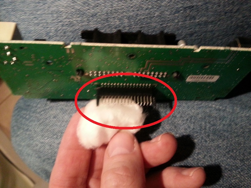

Once you have the RSA unit out, separate the two pieces and gently pull them apart after releasing the 4 end clips, the 32 pin DIN connection is the only one, so pull straight apart don't peel or you risk bending the pins...
Once you have it apart use a cotton ball dampened with at least 50% or higher IPA (alcohol) use that cotton ball to gently wipe the pins to remove any oxidation even if you don't see any... wipe in the direction of the pins to prevent leaving cotton fuzzy on the pins as they can prevent good contact once its put back together.
Give the IPA a few minutes to dry, avoid handling or touching components as your risk ESD damage, this is especial true if you're doing this in a cold dry environment.
The only thing that needs to be cleaned is the 32 pins and the only part that needs to be disassembled is the 2 halves of the RSA unit, the pictures I have below are so you can see the whole unit YOU DO NOT NEED TO TOTALLY DISASSEMBLE.. the front and rear covers.

I had an intermittent buzz (sounded like alternator noise) through my back speakers. If I smacked the center console it quit. Then I found that it could be the rear AC/radio control unit. Before I bought a new one, I removed the control unit and found that it is two circuit boards screwed together with a multi-pin connector. That connector was somewhat loose. So I unplugged it from both circuit boards and then plugged them back in tightly. Reinstalled the unit and no noise since then. Glad I save $120+!!!
