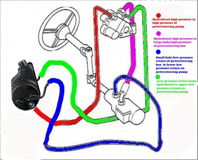

Trying to figure out what lines I need left to replace them all.
Replaced my steering box.
I've replaced GATES 365490 Hydroboost To Gear & the GATES 368640 Hydroboost To Pump.
So I have one more line off the steering box going ??? Didn't have time to chase it yet.
& one more line off the fluid reservoir going back to the hydro-booster.
I might be looking the the wrong category? Any pointers would be appreciated!

Alright found one.
https://www.rockauto.com/en/catalog/...sure+hose,7320
Still looking for the last line off the box.

Just to update for anyone else that comes across this in the future.
Turned out it was a power steering box COOLER. The cooler has the lines built onto that. So new cooler comes with new lines.
Steering box cooler
Blue line in this case goes to the front grill for a cooler.
