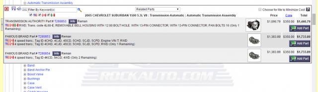

I would also suggest looking for a re manufactured one, without more specifics Rock Auto has them listed for $1700.00 , its nearly plug and play...
Attached Thumbnails Trans out of wife's burb, what models will swap?-suburb05-tran.jpg
