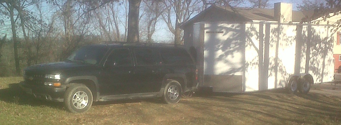

Here is a picture of the rig, you can see it is not a small trailer, there is a huge wind area in addition to the 7000# weight:

I think its the pitched roof and chimney on the trailer that is causing all the wind drag....
gotta love perspective pictures
