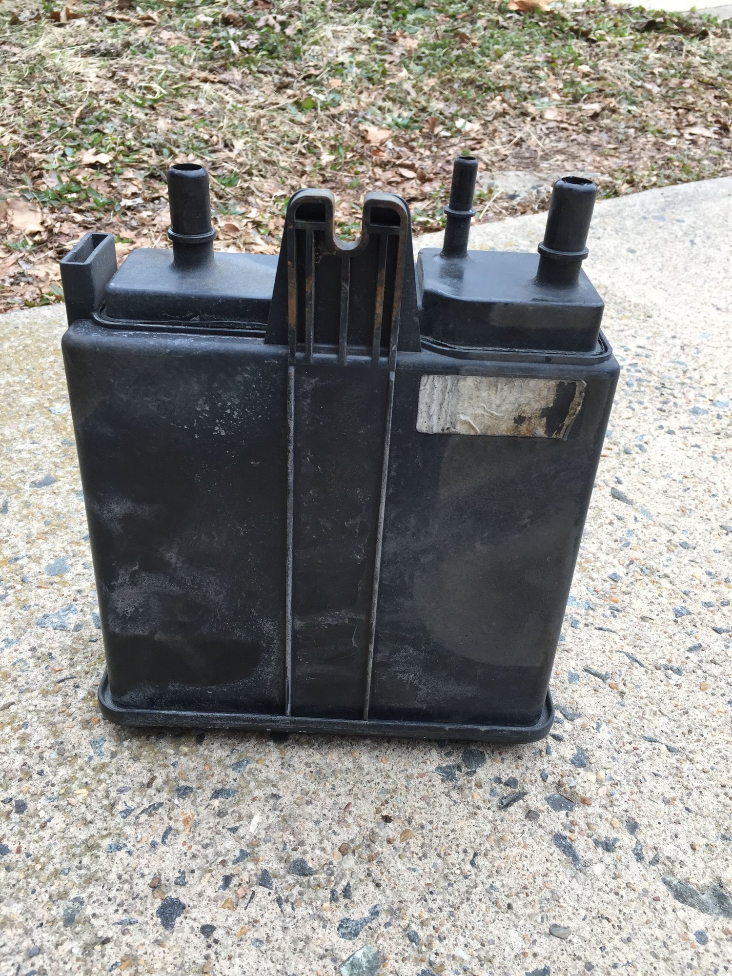

Thanks for the reply tech2! I just need a few clarifications...when you say "go the the evap cannister", do you mean the vapor canister, what I mean by vapor canister is the box with the carbon/charcoal in it?
I am familiar with that "gas pump" symbol from recently watching youtube vids on how to change out the vapor canister.
So let me reword what I think you are saying, since I will try to tackle this tomorow...
Remove the vent line (attached to the port with gas pump symbol) which is attached to the vapor canister (carbon box), then blow compressed air into the line i just disconnected (with the gas cap off ), which will blow air back towards the fuel filler neck (i think), then blow air through the carbon box using the port with the gas pump symbol. Then just find the restriction which will either be the vent line itself, or the carbon box.
If you could pls let me know if I have understood your directions.
I'm hoping that no carbon/charcoal is coming out from the vapor canister, and that just replacing the vapor canister(carbon box) will be my true and final fix for this is.

Thank you sir! I finished the work a few hours ago, before I had a change to read this reply. I did use compressed air, but my air compressor isn't very powerful, its a tiny little guy, I think 1.5 gallons? But when I did blow air through the line, I could hear a delayed whistling noise, not sure if thats normal or not?
So here is an update. Received the part yesterday. Got started on it this morning about 745 or so. I put the rear wheels up on ramps in hopes to give me enough space. Got under the car, located the vapor canister. I was able to get the vent line off, not much effort, I got the line for the vent solenoid off with no effort, BUT the line that runs from the vapor cansister to the engine, which has the blue plastic tab on it, was a PITA!!
I tried getting at the blue connector but its a tight fit and I wasn't able to squeeze both sides down to release the tab locks. I kept fighting with it and fighting with it. Then I decided to drop the spare tire to hopefully get more access, then I could not get the spare tire lock to open! I put the key in the lock and tried turning clockwise and nothing the key would not budge clockwise, I tried tapping the key lightly with a rubber mallet bc it seems the key would not push in far enough. But that still didn't work. Then I just just got white lithium grease and gave a squirt into the lock, let it sit a few minutes, and that did the trick. I got the lock open dropped the spare wheel. It gave me a bit more room to work, but ultimately I had to under the car from the passensgers side and remove the two bolts holding the vapor canister bracket to the frame of the car, and then let the canister just hang while I attempted the blue locking tab for another hour or so. My goodness, I was panicking and getting anxiety b/c I felt like there was no hope of me getting this last line removed w/o breaking something which would cost me more money in the end.
I prayed and prayed and asked God for help on this one, and eventually the line came free from the canister, with no damage to anything, but I did kink the line a bit, but I didn't care much about that, at this point, lol. The kink wasn't too bad and the line is still intact, no breaks in it.
So I get the bad canister out, Thankfully no carbon/charcoal was dropping out from it, so that made me feel better that the lines weren't clogged with the carbon, like a saw in a video on youtube. I got my air compressor out and blew air into the vent line towards the fuel neck filler, and it seems clear, although I did hear a delayed whistle after blowing a burst of air through the line, still not sure if thats normal. I looked down one of the ports on the bad canister and saw some oily like substance down in there, I blew compressed air and nothing blew out that I can tell, but the tip of my air tool had this brown sauce on it from the bad canister.
So anyway, go the new canister bolted onto the bracket, then the bracket bolted to the car, then clicked on all 3 air lines again. Buttoned up everything. Started the car, no CEL's, so now off to the gas station for the real test.
Got to costco, I saw the "fuel used" gauge was at 8.8 gallons, so I got the pump started and just let it pump full speed, while i was holding the lever down. After about 5-7 secs I thought I was hearing the fuel gurgle back up the filler neck, and some anxiety crept back over me, but maybe I was just being paranoid, the pump stopped once, and that was after I had pumped 9.02 gallons into the tank. It seems to be operating as intended now! All in all, it took me about 3.5 hours and just about a third of that time was me trying to release the tabs on the blue connector. If I had a lift, I'm sure I wouldve been done sooner, lol. Its tough to work on my back, and have to fight my vertigo, while do this repair, lol.
I will monitor it and report back with one last update in a few weeks. But I think this one is resolved now! *fingers crossed*
But a big Thank you to God Almighty for allowing me to do this repair properly and save money! And also a Thank you to tech2, you are truly a great help to many of us on this forum!
