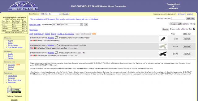

Is this what you are looking for?
http://www.rockauto.com/catalog/x,ca...,parttype,6876
Attached Thumbnails 2007 Tahoe Heater Hose/Core Question-rock-auto-07-tahoe-heater-conn.jpg

Hey fellas. Haven't been on here in a while. Haven't had any problems until tonight. Knock on wood. But my heater core hose broke tonight. Right at the crimp. So I think I need the entire hose. I was able to remove the hose from the core connect and the engine. But I can't seem to find the hose anywhere. I've searched the Internet and only come up with last generation. Which is completely different. It's the hose on the left if your standing in front of the engine bay. The connector that pro listed in the prior post is still good.
