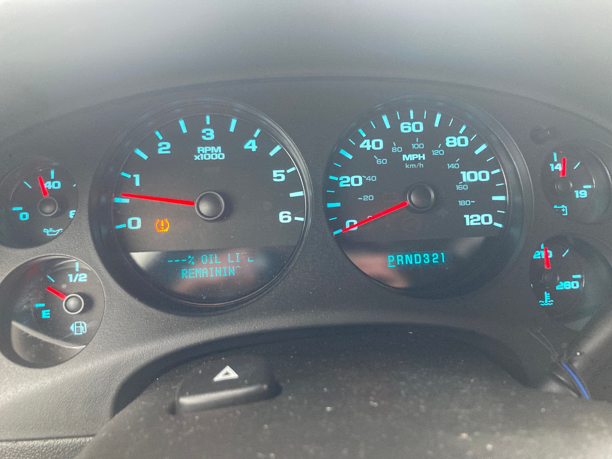

Mine worked fine till I swapped my cluster for another one that had a different style gauge font that I liked. Everything else worked great even though gm said based off the vin the cluster didn’t interchange. So you either have a bad cluster or your cluster has been swapped. The cluster carries the mileage memory
New style font I liked with the - - - oil life error that can’t be reset
so if your cluster has been swapped someone prolly did it to alter the actual mileage of the vehicle sadly.
