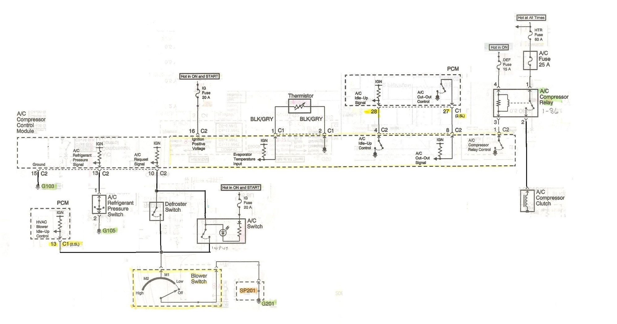

The serpentine belt drives the outer A/C compressor pulley. The A/C compressor clutch locks the outer pulley to the inner compressor. The schematic below shows the control circuitry for the A/C clutch. The 12-volt signal to the clutch can be interrupted by 3 different fuses (HTR, DEF & A/C). The clutch can also be disengaged by inputs to the Compressor Control Module from the refrigerant pressure switch and the PCM (stomp on the gas pedal) cutout signal. If you are getting 12 volts to the clutch and it is not turning, you probably have a bad compre$$or. I am including the theory of operation for the clutch circuit.

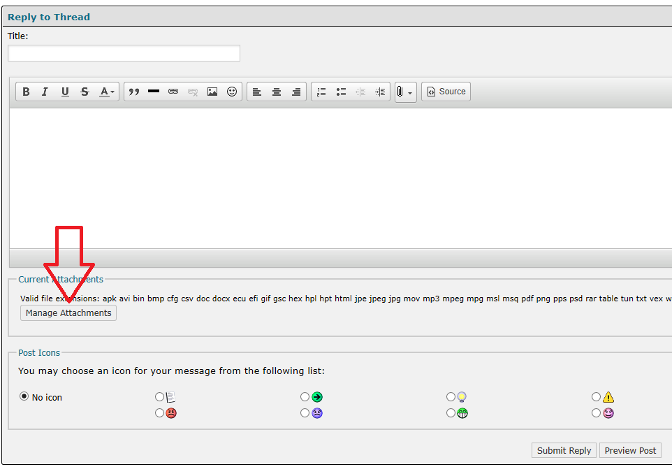

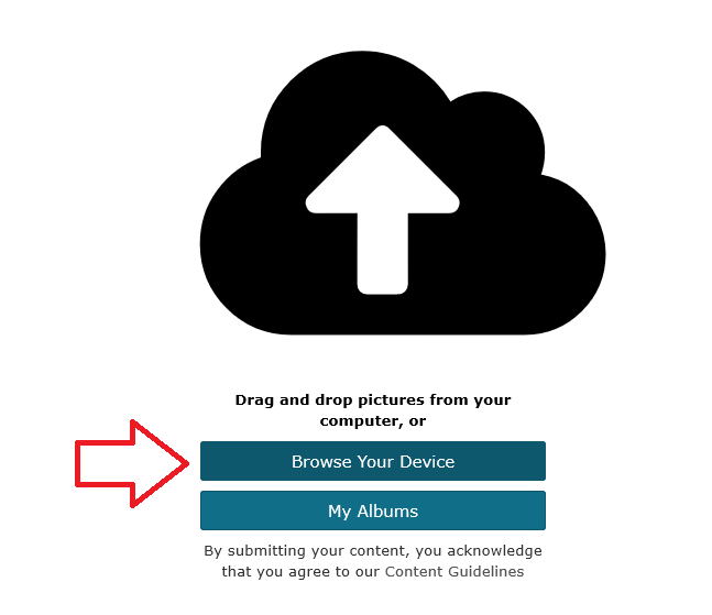

Anyone who can remove a crank pulley can upload a photo. It's a 5-step process.
