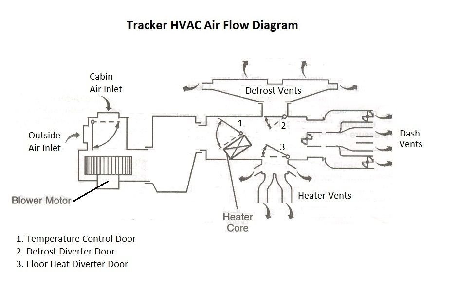

Tracker owners may not be aware hot engine coolant is continually circulated through the heater core located in the heater case inside the cabin under the dash. This circulation occurs even when the thermostat is stuck closed (which appears to be the problem here). When the thermostat is closed, coolant does not pass through the main radiator. Bypassing the radiator for a short time warms the engine block up to operating temperature quickly. Bypassing the radiator too long will cause the engine to overheat resulting in warped heads and an engine rebuild. If your engine overheats: turn off the A/C, roll down the windows, set your HVAC controls to "outside air" with the blower motor set to high. The heater core will act like secondary radiator possibly lowering the engine temperature enough for you to limp home without engine damage. Item 1 in the drawing below is the Temperature Control Door. All it does is force blower air through the heater core for warm air or around the heater core for cool air. Forcing air through the heater core will help bleed off engine heat in the event of a thermostat stuck in closed position.

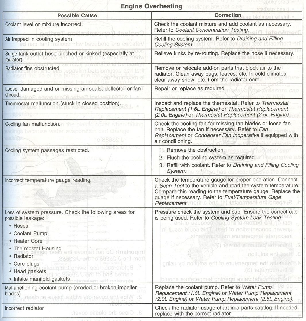

Below is the full list of things that can cause the cooling system to overheat. The thermostat is just one of them (but the most likely). There is no test for a bad thermostat other than "inspect and replace." You could test it in a pot of boiling water but you'd have to remove it from the car first and then you might as well replace it anyway.
