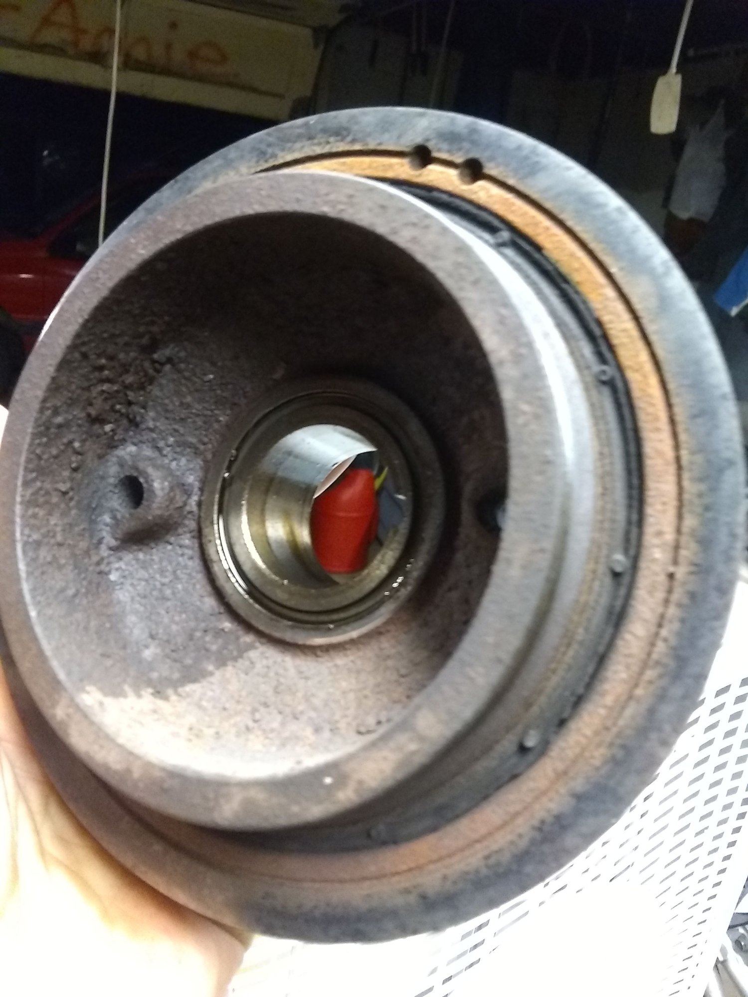

Default Worn out pulley

Default Other side

I love learning new things. Today I learned the harmonic balancer and the crankshaft pulley are two separate
entities pressed together into one unit. The picture below really makes it obvious. Way to go sodafire.

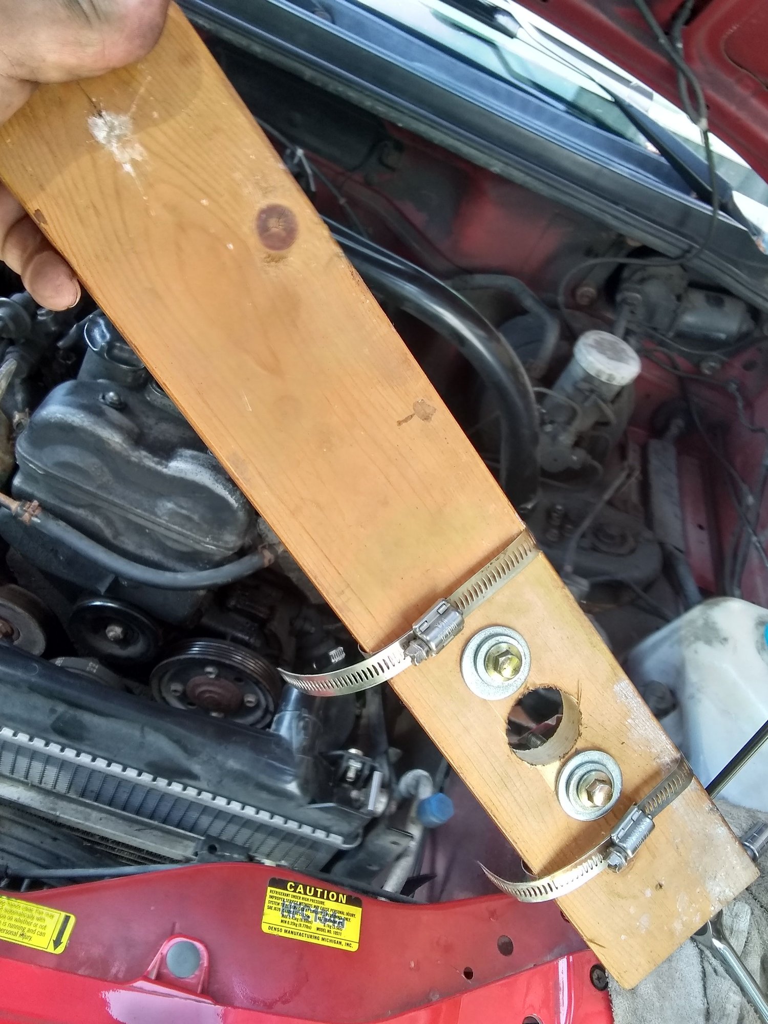

Default She fixed
Heres my homemade "keep it from turning so you can torque it tool". The hose clamps help keep the wood from splitting.

I like your torque tool. I also like your photo. A jpeg is worth 1024 text characters. You did a good thing finding and replacing that faulty pulley when you did. According to the Suzuki forum, not replacing in time can lead to a wobble that will wallow out the key slot in the end of the crankshaft. Once that happens the engine has to be pulled.

Took the ole girl for a test ride after everything was put back in place. Everything looks great, no overheat, no flickering battery light, no stiff steering, and A/C stayed cool. Thanks for liking my "tool". Wasn't sure if a wooden one would work, but it did. Hopefully I'll never need it again. On a side note, I don't know what a "jpeg" is.
