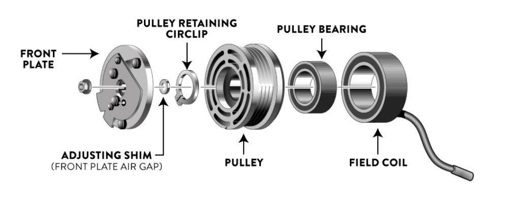

It sounds like you may have a seized clutch bearing. If you can't find a replacement bearing, a good clean and lube may get it spinning again.

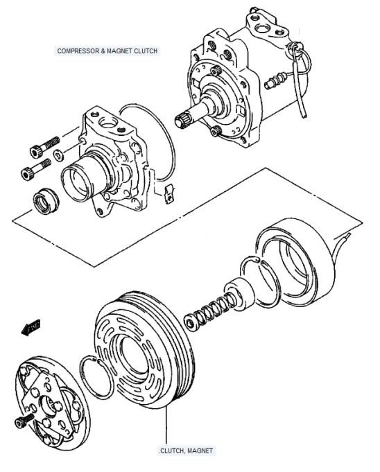

I will look for that. When you sight straight down toward the pump assembly the part closest to the front looks a few degrees crooked. Itys the round plate in the lower left of your diagram. THX

When the field coil is not energized the pulley should turn freely. If the pulley is not turning you either have a bad bearing or the front plate is binding. Removing the A/C pulley is fairly straightforward after the radiator has been removed.
Is the front plate in physical (metal-to-metal) contact with the pulley?

OK WE ARE RUNNING!! The AC compressor was toast. The spray trick loosened it up enough to rotate and make sure it was toast. Turns out that Federated Auto found a 40" belt sold as "power steering" for that year. I had to move the AC out of the way (won't be fixing yet) and adjust the belt idler but it fit. Thanks guys for the diagrams I will keep them for the AC rebuild.
