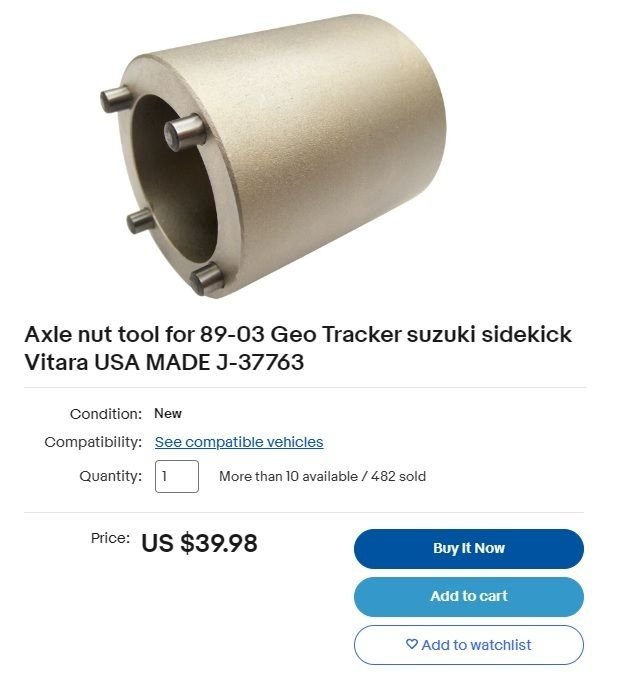

The more difficult part is removing and installing the wheel bearing lock nut (item 7 above).
That requires a special tool (J37763). The installation torque is 159 lb-ft.
