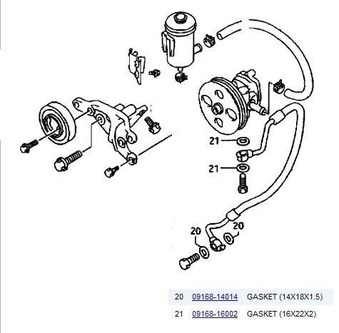

These are the copper washers for the power steering banjo bolts. They are good sized washers.

The copper gaskets on the power steering pump are not the same size as the transmission but they are close.

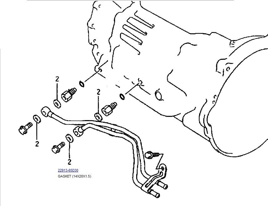

Here are the dimensions (in mm's) for the GM part number you provided.
Turns out it's the same size gasket on your oil pan drain bolt.

No! The power steering banjo bolts are not the same size as the transmission bolts. I just had picture of the P/S bolts to indicate their relative size. Do not remove the P/S bolts. Just get the correct copper gaskets from Amazon.

I would just buy the correct size (14x20x1.5) copper washer from Amazon. If that is not an option these aluminum washers from RockAuto are also 14x20x1.5
